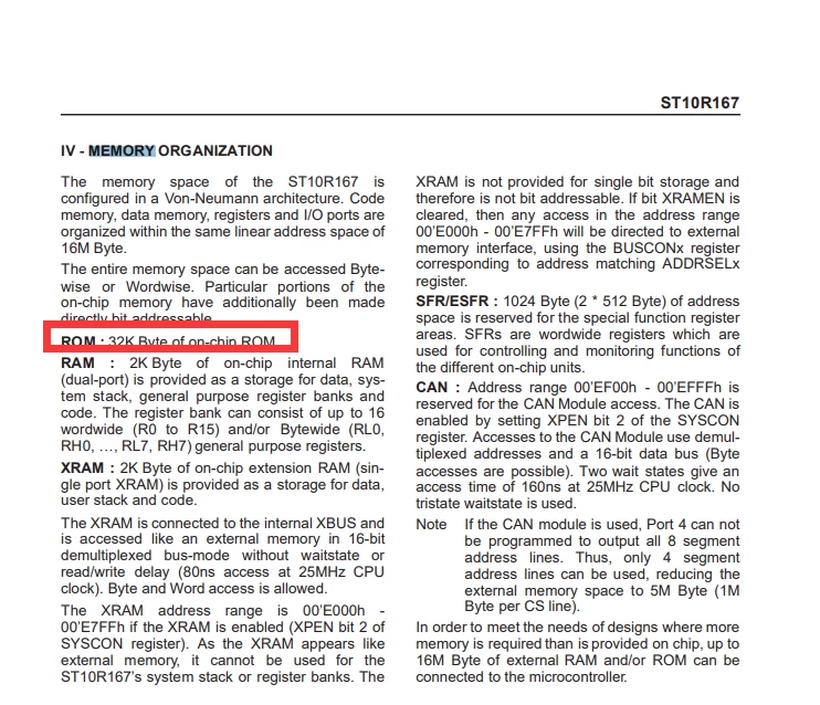

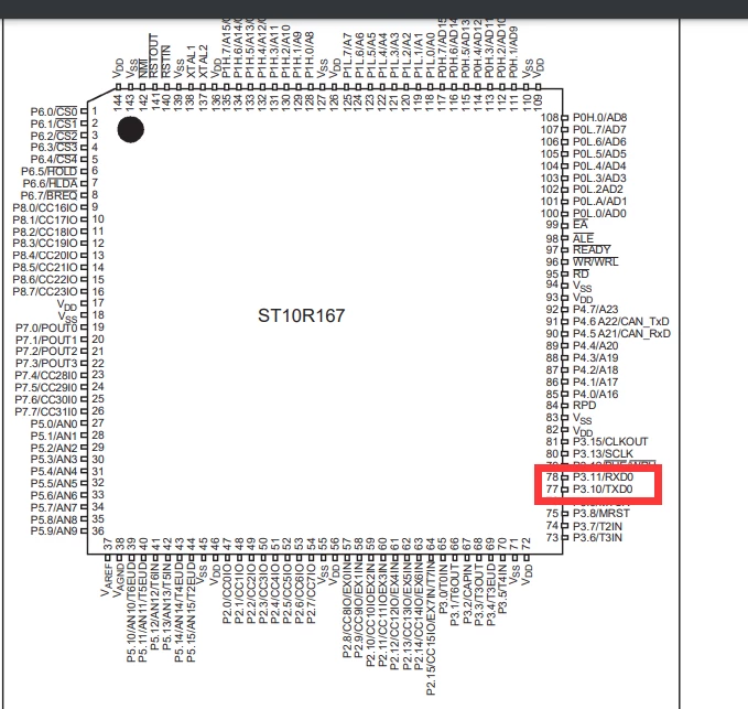

st10r167 has 32kB internal ROM
_legacyfs_online_stmicro_images_0693W00000bjE3RQAU.pngIt can be programed by TXD and RXD, st10 flasher tools
