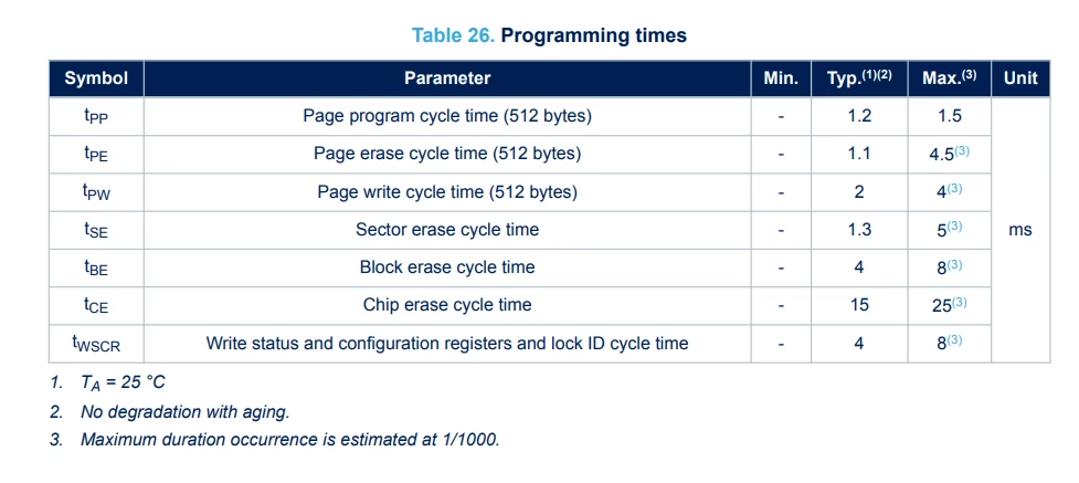

I am using EEPROM M95p32I for my project. I need to do the power calculation based on the load and bytes of data I'm using in my project. Like for reading 30 bytes of data or writing 30 bytes of data.

For write, the number of bytes written is don't care as the internal write is done in parallel of 512 bytes.
So whatever the number (1 to 512) you will have the same consumption.
Find below the estimated consumption of the device. Of course depending on your hardware ecosystem,the consumption may increase.

While calculating the energy consumed in M95P32I. We need to calculate the time duration it is going to write and read the data. As mentioned in the datasheet few " ms " is given as shown in the table given below.
0693W00000Y8JGyQAN.pngSo, is there any way to calculate the approximate time to write and read the data.
Pierre P.
January 16, 2023
you can follow the typical values in table 26. They are extracted from product characterization (all range of temp/Vcc)
