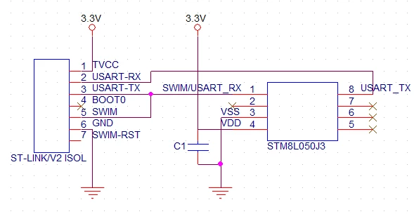

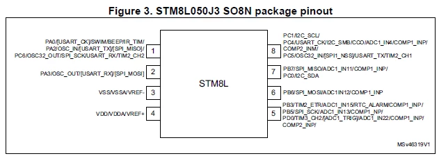

How to use UART at STM8L050j3?
Using STM8L050j3, ST LINK/V2 ISOL, STVD.
I am studying the UART and i have connected MCU and ST LINK/V2 ISOL.
They use SWIM with USART TX / RX Pin.
A problem is that PC don't receive the any text.​
I think that cording is fine(easy example) but i suspect that the PC and MCU are properly connected.
Checked the USART parameters(Baudrate,Wordlength,stopbits,Parity...) on S/W and cording.
Used the various terminal S/W.
Swaped the MCU.
Please let me know how to use UART.
best regards.

    dbgarasiya
    Senior
    Jan 28, 2020 5:20 AM UTC
    should be enable interrupt
