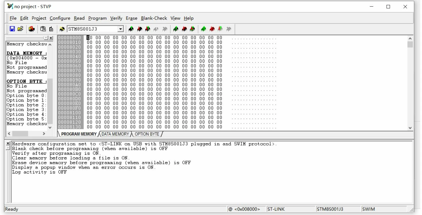

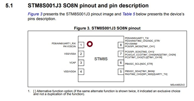

How to program STM8S001J3 chip with 8-pin with ST-Link V2?
0693W000008zbOsQAI.jpgSince there was no "RST" or "NRST" pin on this chip.

    MQi.1
    MQi.1Author
    Senior II
    April 15, 2021
    I read this just now, as I understood, if I used pin 8 as PD5, no setting is needed since PD5 is the default configuration of pin 8.
    If I want to use pin 8 as SWIM, then I need to set this in Option Word.
    If I want to reused pin 8 as PD5 or PD3/PD1/PC6 after I have configured it as SWIM , I need to delay 5 seconds before altering.
    Is that right?

    MQi.1
    MQi.1Author
    Senior II
    April 15, 2021
    While, I found no item for SWIM in "OPTION BYTE" of STVP, how to configure it? Is "SWIM" would be the default configuration if I haven't used PD5/PD3/PD1/PC6, since it already shown in the bottom-right corner - "SWIM"?
    WilkoL
    Senior
    April 15, 2021
    Can you find something about the delay they talk about? I do not have this chip (and I'm not going to buy this weirdo) so I cannot check anything. I'm afraid it comes down to RTFM :)
    Cristian Gyorgy
    April 15, 2021
    Hi! I don't really understand what you guys talk about. Programming this chip is easy and straight forward, if you understand what you are doing.
    First thing to understand is that on these 8-pin devices, the multiple ports you have on one pin are internally tied together.
    Second thing, if you don't have a reset pin, than in order to program the device you need the SWIM pin functional. This means, all ports tied to it: PD1 (actual SWIM), PD3, PD5, PC6; need to be inputs and not driven externally.
    The 5 s delay in the manuals is just a possible solution for programming, to wait before you can configure any of these ports as outputs, and before you disable SWIM from within the application. But you can also use different solutions, like checking another pin's status at startup, to know if you start the application code or wait for programming - this depends on your setup, and what you have available to signal this.
    The startup delay is healthy to use until you have a functional code, not to lose the device by some mistake.
