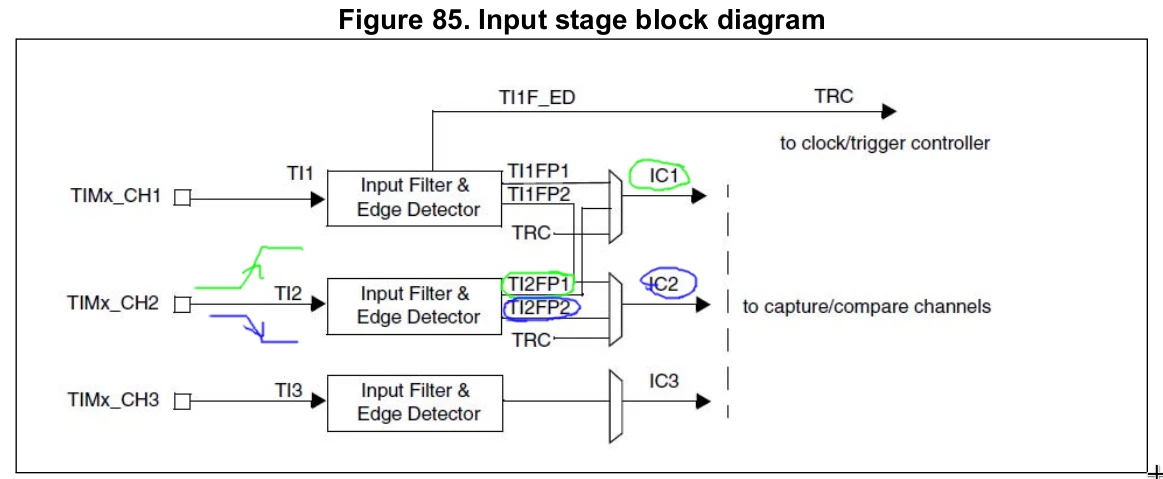

    Cristian Gyorgy
    September 24, 2020
    So, I don't know your setup, but you say you want to use TIM2_CH2 input pin. You could setup TIM2 the following way:
    (The image above is from RM0016)
    Set inputs for channels 1 & 2:
    TIM2_CCMR1 = 0x22 (N=4 samples filter, input for CH1=TI2FP1)
    TIM2_CCMR2 = 0x21 (N=4 samples filter, input for CH2=TI2FP2)
    now you need to set the active edge and enable capture:
    TIM2_CCER1 = 0x31 (rising edge for CH1 and falling edge for CH2).
    You still need to enable the capture interrupts and maybe also the update interrupt to keep track of time.
    Every edge will capture TIM2 value, and then you have enough time to read the captured value. Simple math, by subtracting the time between 2 edges will give you the captured signal.
    Good luck!

    You have separate interrupts on TIM2 for Capture and for Update. When the input capture channels catch an edge, the TIM2 capture/compare interrupt is triggered. Inside the interrupt, by reading TIM2_SR1 register you know which channel triggered teh interrupt: check CC1F/CC2F flags. After you know the edge you can read the captured value in TIM2_CCR1/2. The interrupt flag is reset by reading the value.
    "Set the timer like you offered, but my micro controller is always rebooting after that, and there is no any interruption" - what are your interrupt handlers? Watchdog enabled? An unhandled interrupt will reset the MCU if there is no code at the int. vector or if the interrupt flag remains set and jumps continuously to the int. vector.
