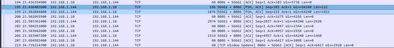

I’m busy with the implementation of a TCP server that needs to handle a TCP connection with already existing PC application that I can’t change.
Everything works well as long the packets are not longer then 1500 bytes. When the packets are longer than this “magic number” LwIP is separating the packets in more than 1 piece. Is there a way to know the original length of the original packet?
See print screen Wireshark: Packet with length: 1876.

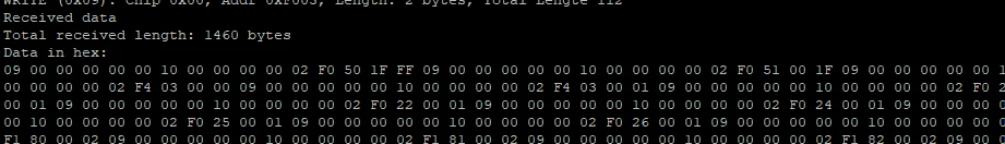

Debug from the controller:
First read:
 Second read:
How can I detect that these 2 reads (netconn_recv) are 1 packet? Instead of 2. I use the NETCONN API.

The MTU is around 1500 bytes, which means the maximum size of the Ethernet frame cannot exceed that. Therefore, a TCP packet larger than this, like in your example, is split into smaller packets, to fit inside the MTU.
Are you using a known protocol on top of TCP (HTTP, MQTT, etc.)? Or is it just raw TCP? Normally, if it would be raw TCP (a custom protocol), you would have to implement the message framing by yourself, more precisely marking the beginning and end of each packet and parsing the packet.

Thanks for your answer. In was wondering that i forgot something how to get the total length for spitted package.
Well a protocol, not really,  it is uart communication collected in a TCP stream, it can contain one command, but also multiple commands and also the start from an command and the other data can fit inside other TCP packet(s), the max size that i already found was 12K. There is also no documentation. This makes it very hard to write the software that works, always.

Ideally, you would want to have an application protocol on top of TCP to frame that byte stream. With raw TCP alone, it’s almost impossible to know the boundaries of each message.
A simple example would be this: each message starts with a header containing the message length. You read the header and get the message length, then keeps reading from the TCP stream until you’ve  received the specified number of bytes. That makes the stream much easier to parse.
Though I understand that you can’t control the sender, the PC application, so you have no control of the message framing. Perhaps there are some useful headers/commands, like you mentioned, and you should use those to establish the boundaries of each message. If you manage this, then the issue should be solved.
