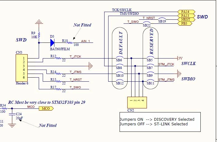

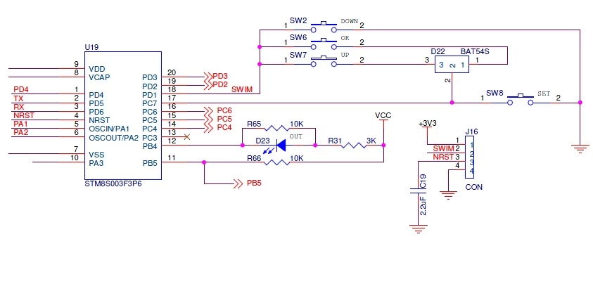

How to debug STM8S003F3P6 using STM32F0308-Disco
Posted on February 26, 2018 at 12:54
         I m having STM32F0308-Disco board and
STM8S003F3P6. I want to debug STM8S003F3P6 using STM32F0308-Disco board.Here circuit images are attached.   Please tell hardware connections for that.
