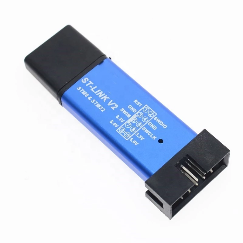

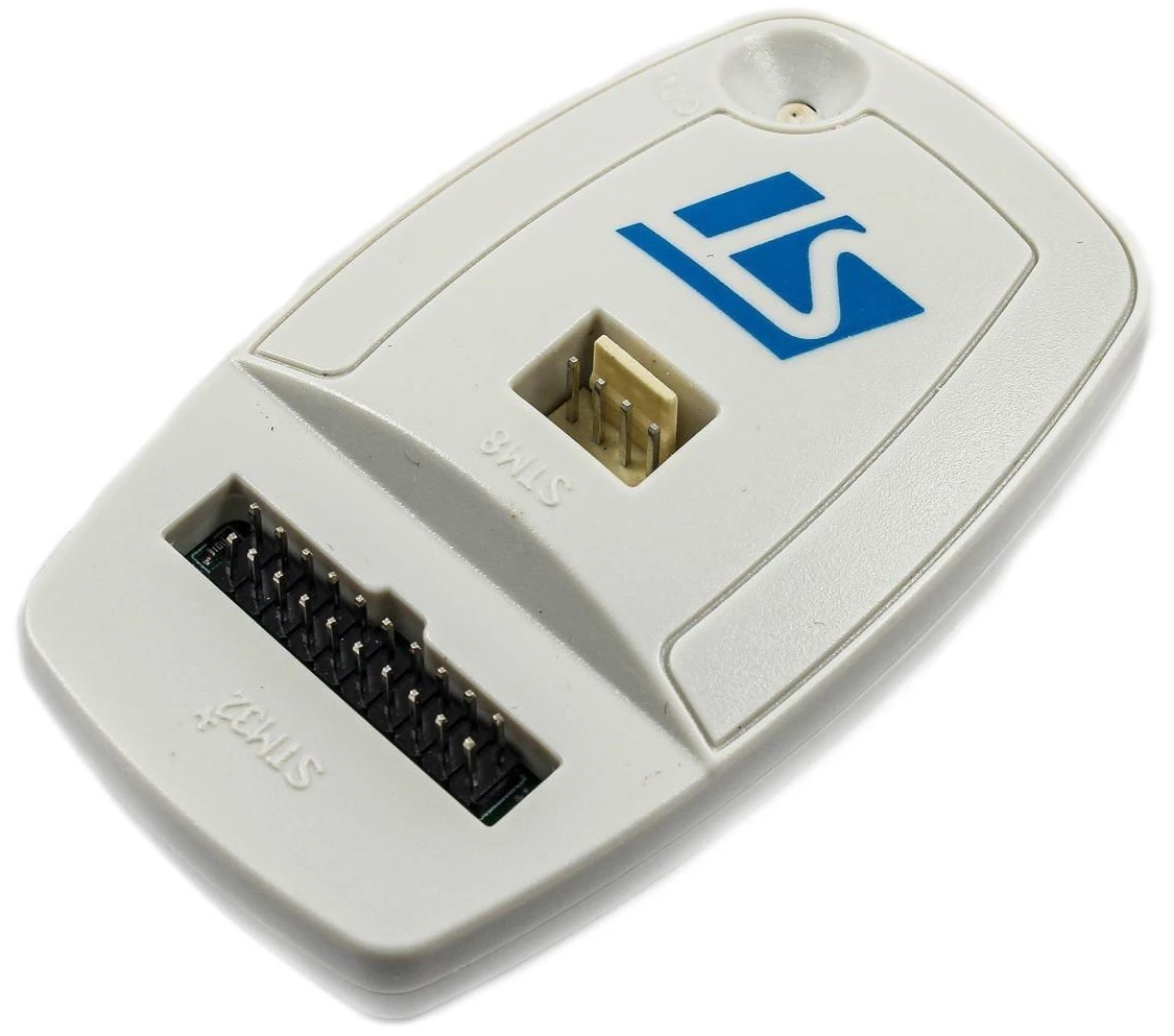

Hi
I plan to program my MCU using a Tagconnect cable. I haven't bought the Tagconnect cable yet, nor the st-link v2, and I would like some recommendations.
Is anybody using this setup? What are your thoughts?
It also seems there are different versions of the st-link v2, but with the same name:
I prefer the small thumb-drive like, if they are functionally equivalent.

The thumb-drive one is a boot-leg design.
Should however present 3.3V and 5.0V at the connector, could power with that.
The Authentic ST-LINK/V2 provides power via pin 19 of the 20-pin JTAG header, whereas pin 1 and 2 expect the Target's voltages for the buffers on the pins.

JMala.3
May 21, 2022
Yes we use the tag-connect cables on our boards. We use the ST-Link-V2, (the white one in your picture) the tag-connect adapter, and the tag connect cable (10 pin version)
https://www.tag-connect.com/product/tc2050-arm2010-arm-20-pin-to-tc2050-adapter
https://www.tag-connect.com/product/tc2050-idc-nl-10-pin-no-legs-cable-with-ribbon-connector
