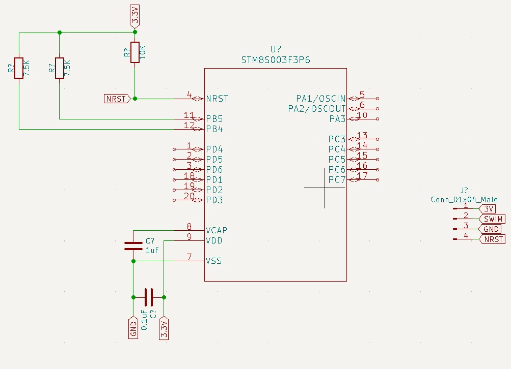

How to check open drain pins PB4 and PB5 working properly for I2c communication [STM8S003F3P6]
  • March 17, 2022
  • 0 replies
  • 1290 views
I am trying to get I2C working for STM8S003F3P6 with ESP8266. I tried I2C sample code available with standard periferal library https://www.st.com/en/embedded-software/stsw-stm8069.html . But for some reason I2c is not working. Now I just noticed the I2C pins PB4 and PB5 marked as open drain without any protection. So I wanted to check if I bricked these pins during my earlier testing sessions. So I written simple code to output on PB4,PB5 pins below, but I am not getting voltage on the PB4 and PB5 pin. I am getting correct output on PD4
static inline void delay_ms(uint16_t ms) {
I am using above circuit, I have pulled up PB4 and PB5 as these are open drain pins. I am measuring output from PB4 and PB5 pins and ground.
Can someone help if above setup is correct and if not how to check if PB4 and PB5 are not broken
