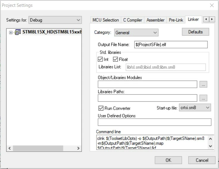

I WANT TO calculate Thermistor temperature, but did not find a log funnction

    First in STVD you need to configure the linker to enable the standard library for floats as shown in my attachment.
       volatile float r=100.0;
       volatile float ln=log(r); // calculate Napierian logarithm
    volatile float l10 = log10(r); // calculate logarithm to the base 10
    include of course math.h
    Hopefully it will help you.
