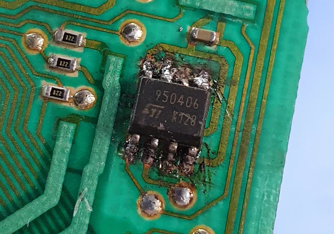

Hi there! I wanted to politely ask for your help, if you can answer a simple question: i have a 950406 k128 eeprom chip but cant find one to buy online i only can find 950406 K506W or 950406 K304K, if so can i use these other ones to replace the95040

It is for a veglia boreti automotive instrument cluster from a fiat punto 2001 - 1999
Hi there! I wanted to politely ask for your help, if you can answer a simple question: i have a 950406 k128 eeprom chip but cant find one to buy online i only can find 950406 K506W or 950406 K304K, if so can i use these other ones to replace the 950406 k1280693W000008zx6MQAQ.jpg

Investigations on going...
I will contact you asap.
BR
Team EEPROM SuPPort

Pierre P.
April 26, 2021
After investigations, you can use both of the 2 parts.
But i would recommend you to use the 950406 K304K which is manufactured with the last process technology.
BR
Team EEPROM suPPort

thanks a lot the brand doesnt matter right? ;)
