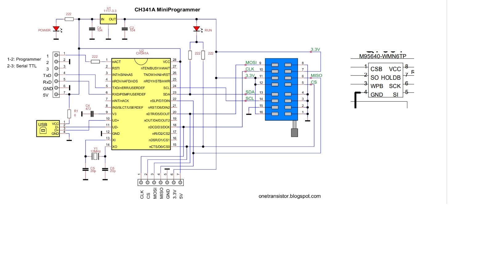

Hi, My Onkyo receiver got frozen and behaving stubborn. Can I program M95640WP using CH341A Programmer any help in this matter shall be highly appreciated. datasheet included here https://ibb.co/1JTWkLs thanks in advance Modify message

MM..1
August 24, 2020
Seems when you rotate memory IC and place it to upper 8 pin in programmer, then connection will be ok.
Next step is sw setup....
Pbhat.1
Pbhat.1Author
August 25, 2020
thanks for the suggestion.
I was also thinking the same way but, surprised to see that on reversing the IC the programmer's 7th & 8th point (11 & 12) both having 3.3V
MM..1
August 25, 2020
Pin HOLD is too connected to Vcc then no problem here, i mean bigger step will sw .
