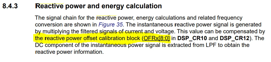

Hi.I use stpm32 as metering chip.The protocol what I use is SPI.why the sign of reactive energy is wrong but the sign of active energy is correct?
  • July 3, 2021
  • 5 replies
  • 2401 views
The amount of reactive energy register is decreased while I expect it to be increased.I use a reference meter" to ensure the sign of reactive energy.what should I do?
Could my stpm32 chip be fake?

Hello @Mpanj.1​ ,
If you suspect that the chip is fake, please provide a high resolution photo of the said chip.
Otherwise, check the value of OFRx[8:0], it might be causing the issue.

Hello @SBEN .2 ,
Thank you for your answer.
The value of the active and reactive energy is correct but the sign of reactive energy is wrong.
I tested the chip in 230V and 10A and +45 degrees phase difference with a reference meter.But the problem still remains.
I send a photo of my chip.
Thanks.

Hello @Murtaza Panju​ ,
Are you sure that Phase and Neutral aren't switched up?
Best regards,
@SBEN .2​
Mpanj.1
Mpanj.1Author
July 5, 2021
Hello @SBEN .2​
I am sure because the sign of active power is correct and the value of active energy register is increased as i expect.But the value of reactive energy register is decreased and the sign of reactive power is negative.
The load i was applied is inductive.
The error measurment is less than 0.2%.
Thanks.

Hello @SBEN .2​
I changed the chip with a new one that I bought from another online shop.
All problems asked, were resolved.
The old chip was fake.
