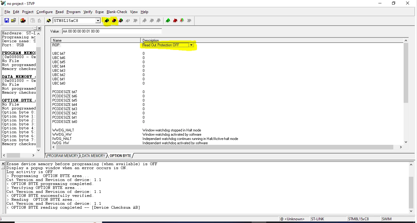

    Hi Tesla DeLorean,
    Thank you for your prompt support. I'm using the MCU STM8L151C8.
    I solved it with the following steps:
    1. Changing ROP to OFF
    2. Program memory
    3. Read memory
    _legacyfs_online_stmicro_images_0693W00000bj3LZQAY.pngBest regards,

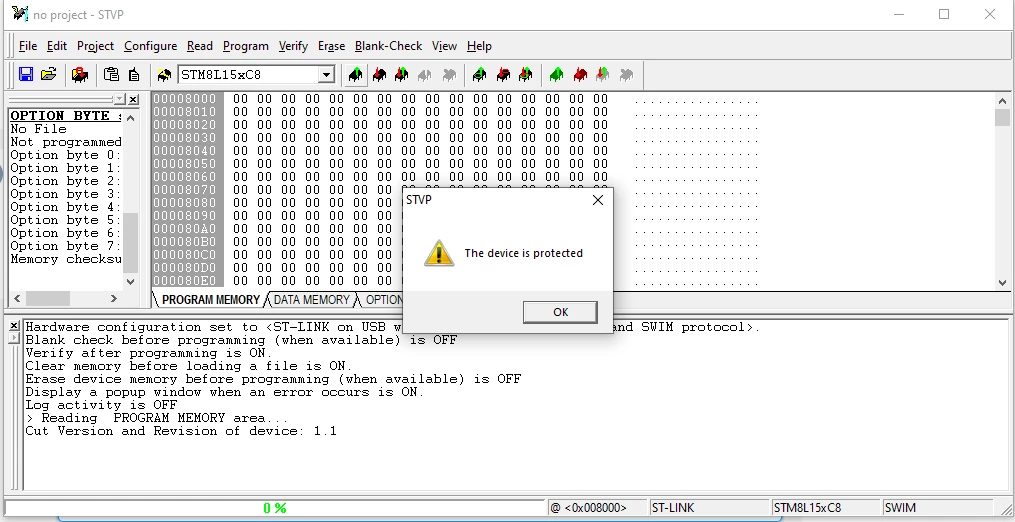

    Hi experts!
    Do you know what is my issue? and how can I solve it?
    _legacyfs_online_stmicro_images_0693W00000bizT5QAI.pngI'm using the ST-link v2 with the STM8 part as you can see below.
    _legacyfs_online_stmicro_images_0693W00000bizTAQAY.pngNote: I'm sure of the MCU part number.
    Thank you in advance!

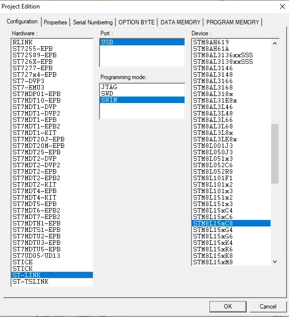

    Maybe target MCU selection is wrong. Try select STM8L151x8. See more in UM0991 page 24.
    If target MCU selection is ok, you need to remove option bytes readout protection.

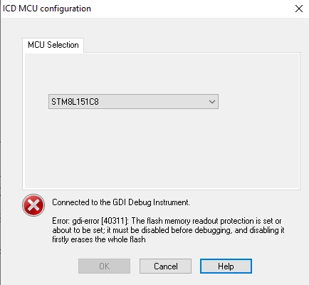

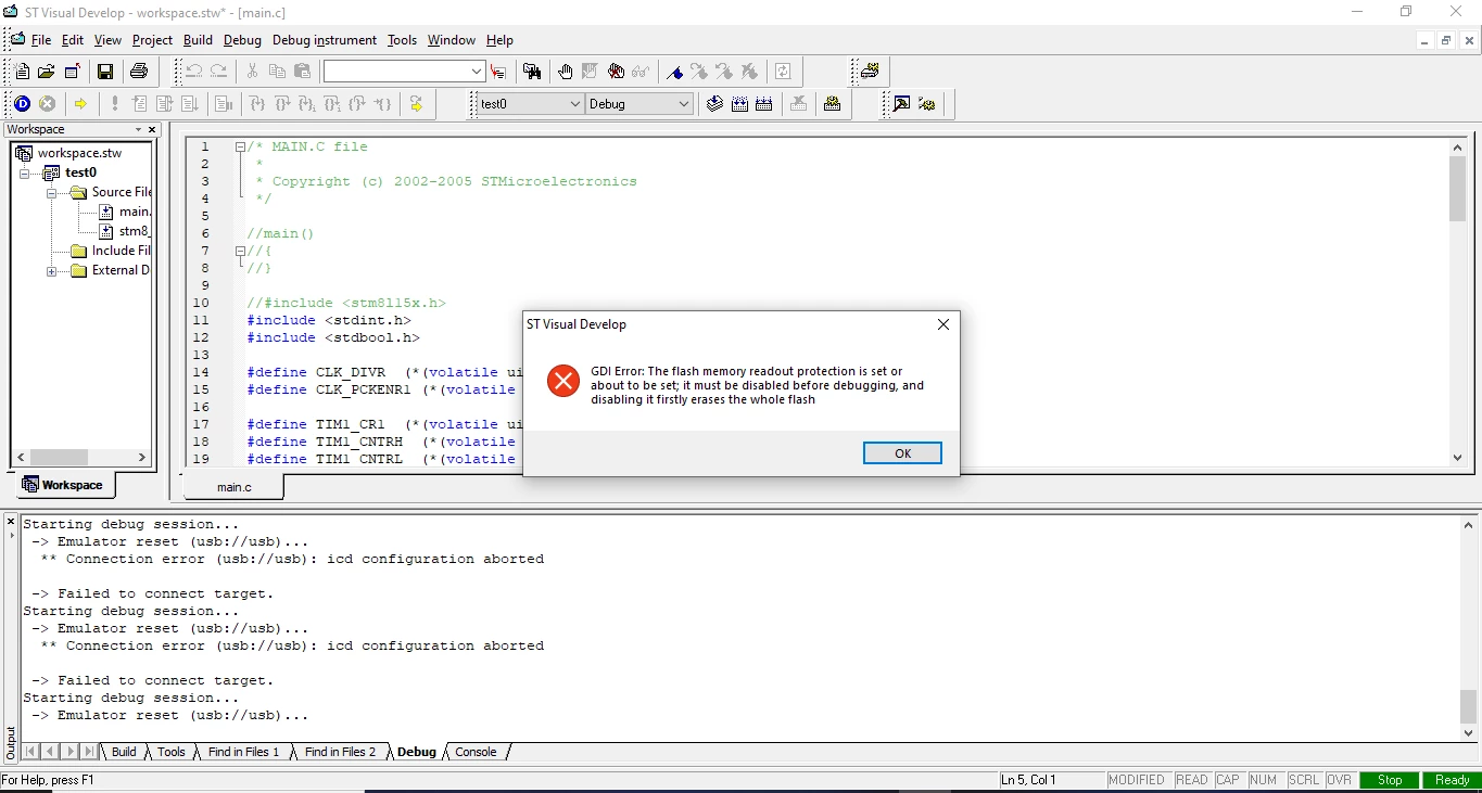

    April 28, 2023
    When I tried with STVD programmer I got this.
    _legacyfs_online_stmicro_images_0693W00000bj39JQAQ.pngDo you know what this issue is?
    Thank you in advance.

    It's either protected or not properly connecting..
    Can you ERASE it to remove the protection?
    Is this a device that has successfully been used before?
    Any staff at your organization who have used these parts/tools previously?
