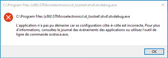

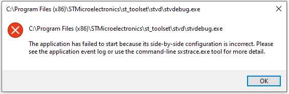

Hi All, Error with "ST Visual Develop". Whenever try to open STVD always gives an error as per attached picture. Could you help me out with this error, as I am new to this platform. Thanks!!!

    That's a pity. I have seen the side by side error before but not with STVD. Google pointed me to this page where they seem to suggest that it may be something to do with Microsoft Visual C++
    https://www.minitool.com/news/side-by-side-configuration-incorrect.html

    But when googling about the "side by side" error it seems to be a problem with Microsoft Visual C++.
    So I took a look at what I have installed on my Windows10 x64 PC.
    It is quite a list, considering that I do not do anything with c++ :grinning_face: .
    • Microsoft Visual C++ 2005 Redistributable
    • Microsoft Visual C++ 2010 x64 Redistributable
    • Microsoft Visual C++ 2010 x86 Redistributable
    • Microsoft Visual C++ 2013 x64 Redistributable
    • Microsoft Visual C++ 2013 x86 Redistributable
    • Microsoft Visual C++ 2015 x64 Redistributable
    • Microsoft Visual C++ 2015 x86 Redistributable
    Maybe re-installing one of those will help.

    Tanks for your answer ! It was a problem with Microsoft Visual C++ 2005 Redistributable. After re-installation, it works !
    Thanks for your help !
