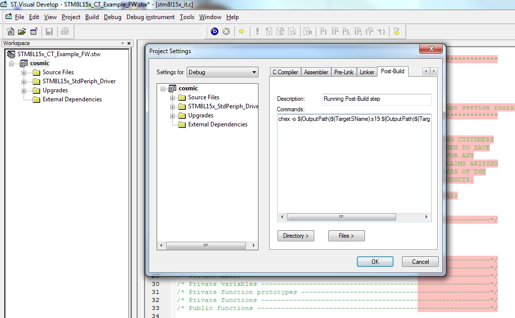

Hello,Can Any One Tell me how to get .hex  file in stvd

    If it is to generate the HEX file, it is in the project properties.
    something like this:
    This is an old project... it might look different with newer toolchains.
