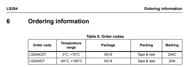

I need help identifying a particular ST SOIC 8 op amp.
It has the markings: 204/ 9125
I hope to hear back from you as I am interested in this op amp but I cannot find out what it is.

Maybe LS204 , dual opamp:

Thank you. These seem to be obsolete now.
AScha.3
September 21, 2025
Seems so - but its nothing so special;  i would try as replacement : NCV20072DR2G
at mouser: 863-NCV20072DR2G , 50 ct . (also up to 36V , 3MHz GBW , dual opamp in so-8 )
or even a 4558 might be ok, if you have some around;
at mouser: 595-RC4558DR , 20 ct.
