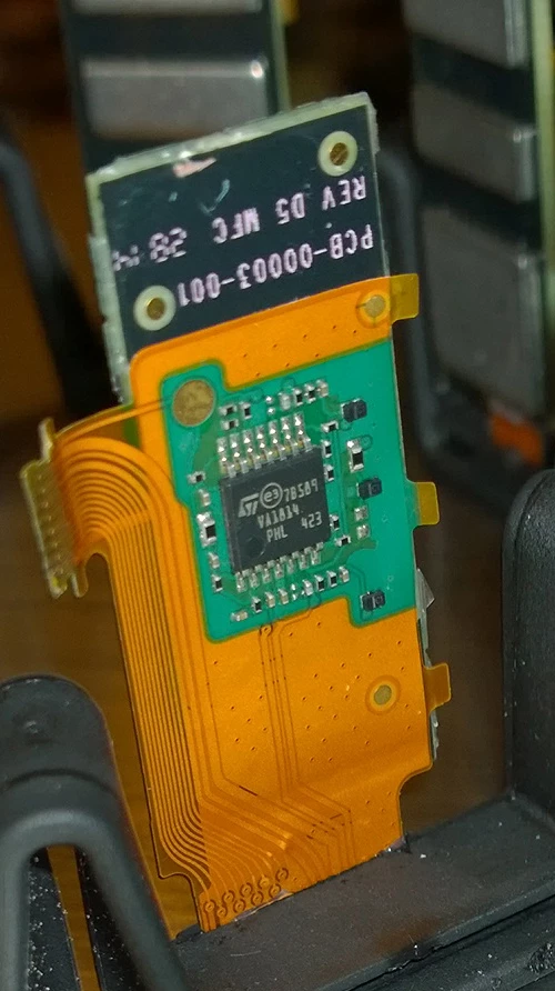

Help identifying quad OP Amp
0693W00000FDiFkQAL.jpgSee picture above for exact markings. No markings on the bottom of the IC.
Battery powered device (low voltage)
Markings:
ST (e3) 7B589
VA1814
PHL 423
Alternate version has similar markings. Maybe just a date code change?
ST (e3) 7B474
VA1814
PHL 423

Peter BENSCHBest answer
November 4, 2021
Well, it's already published, just not where you expected it to be. As already stated, it is instead labelled on the box/packaging in which it is delivered.
Anyway - yes, I'm 100% sure VA1814 is the marking for TSZ124IPT.
Regards
/Peter

October 27, 2021
My money is an ST second-source/equivalent to the LT1814
https://www.analog.com/media/en/technical-documentation/data-sheets/18134fa.pdf

@Community member​ is not completely right, it is the TSZ124IPT with marking VA1814.
