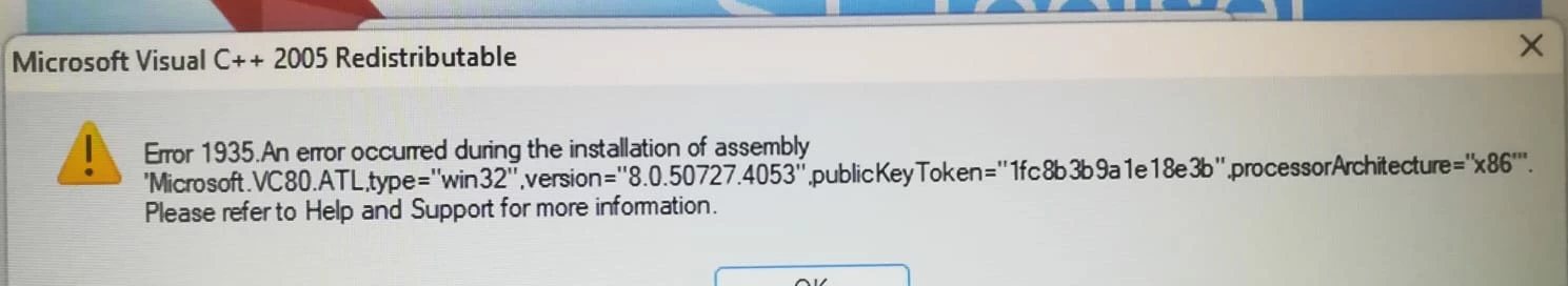

Hello, When I installed STVD V42.0.0 on the WINDOWS-11 laptop there is showing an error, I attached it. Please guide how I install it. Thank you.

    We are very sorry that you are having problems with STVD on Windows 11. The RN0013 only mentions Windows 7, 8 and 10, but it could be (untested, no guarantee) that you can get STVD to work with Windows 11.
    STVD was developed many years ago when there was a different file structure under Windows. At some point Microsoft renamed the programs folder to "program files" and the inserted space often creates issues.
    Please try whether the error message also appears if you install STVD with admin rights in another folder without a space, e.g. to C:\ST\STVD

    Thank you so much Mr. Peter Bensch it's working and STVD IDE install successfully without no error on the Windows11 machine.

    Hi, Mr. Peter first time it installs and runs error less, the second time run error less after restarting the system it also works, But the next day there is shown the same error message and it is not run (work). By default Microsoft Visual C++ 2005 is not in the control panel after installing STVD it shows and the next day is not present in the control panel automatically.
