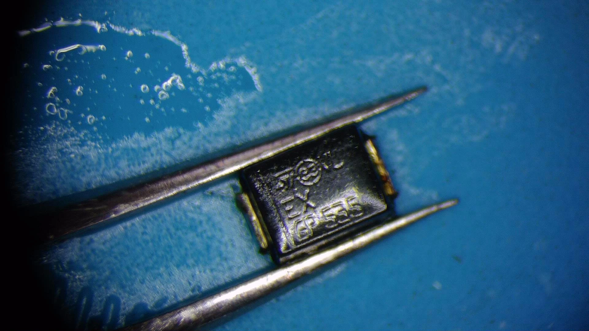

Hello everyone. Could someone please provide data sheet (orsuggest a suitable replacement) for GP535 made by ST. It appears to be a TVS diode but i can´t find any information when i google. Attached is a picture of the diode. Thank´s in advance.

That's NOT the part number/identifier
SM6T39A
https://www.st.com/resource/en/datasheet/sm6t39a.pdf
It is a current product, and I think Vishay also has a substitute.

Okay. Thank you so much for your help. I don't have access to the circuit diagram and that was the only number I could come up with. Again thanks so much.
