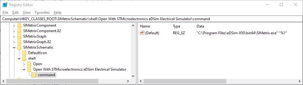

Got the following error when I tried to click on the .bat file generated by eDesignSuite. No value found for registry key: "HKEY_CLASSES_ROOT\SIMetrixSchematic\shell\open with STMicroelectronics eDSim Electrical simulator\command"

If that value in the registry is empty, maybe the eDSim installation has been done and completed with a different user respect to that one you are using now to lauch the .bat file. Could you verify?

Thank you, it is all good now.

Hi @EHD​ ,
you should see something like this in your registry:
With the reg key reporting something like this:
"C:\Program Files\eDSim-850\bin64\SIMetrix.exe" "%1"
