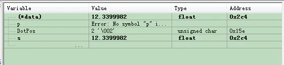

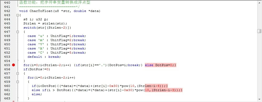

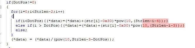

set a floating-point (*data) , (*data) = (*data)/(pow(10,Strlen-3-DotPos)),(*data)=1234,pow(10,Strlen-3-DotPos)=100, the result was 12.33999 how did that happen? And I want to get an a
precise result 12.34.  How to do? Right now I am doing my project by your MCU and I am eager to know the answer! Thank you !!0690X00000602jWQAQ.jpg0690X00000602jbQAA.jpg0690X00000602jlQAA.jpg

    floating point data are approximate representations: look it up on the internet to get the basics.
