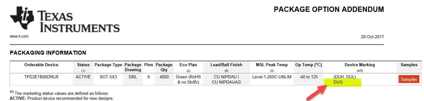

Find part from marking code
  • May 13, 2019
  • 3831 views
I am trying to find ST micro part from the marking code on it. I think it might be an ESD protection diode or a Transistor. Marking on it is either DUG or 7C
Can someone help me find the part number from this?

Looks to me to be a 6 pin ESD diode array (by TI - not ST) and the device in front is most likely an EMI filter.
See this datasheet from Texas Instruments:
https://www.ti.com/lit/ds/symlink/tpd2e1b06.pdf

THANK YOU!!! I cant describe how grateful i am you identified this for me, ive been trailing the internet for a week!
