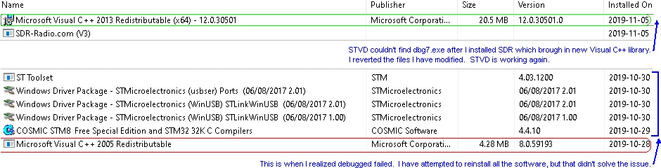

    I think I found the problem. It is caused by STVD have some compatibility issues with some version(s) of visual C++ library.
    Circle in red is when the problem starts to happen. Circle in green is when the problem resolved.
    I noticed that STVD installer skipped MFC when I try to uninstall and reinstall. ST should make sure that a proper version of VC++ library is installed.
    Note: similar issues back in 2016, 2018. ST don't seem to have anyone working on it.
