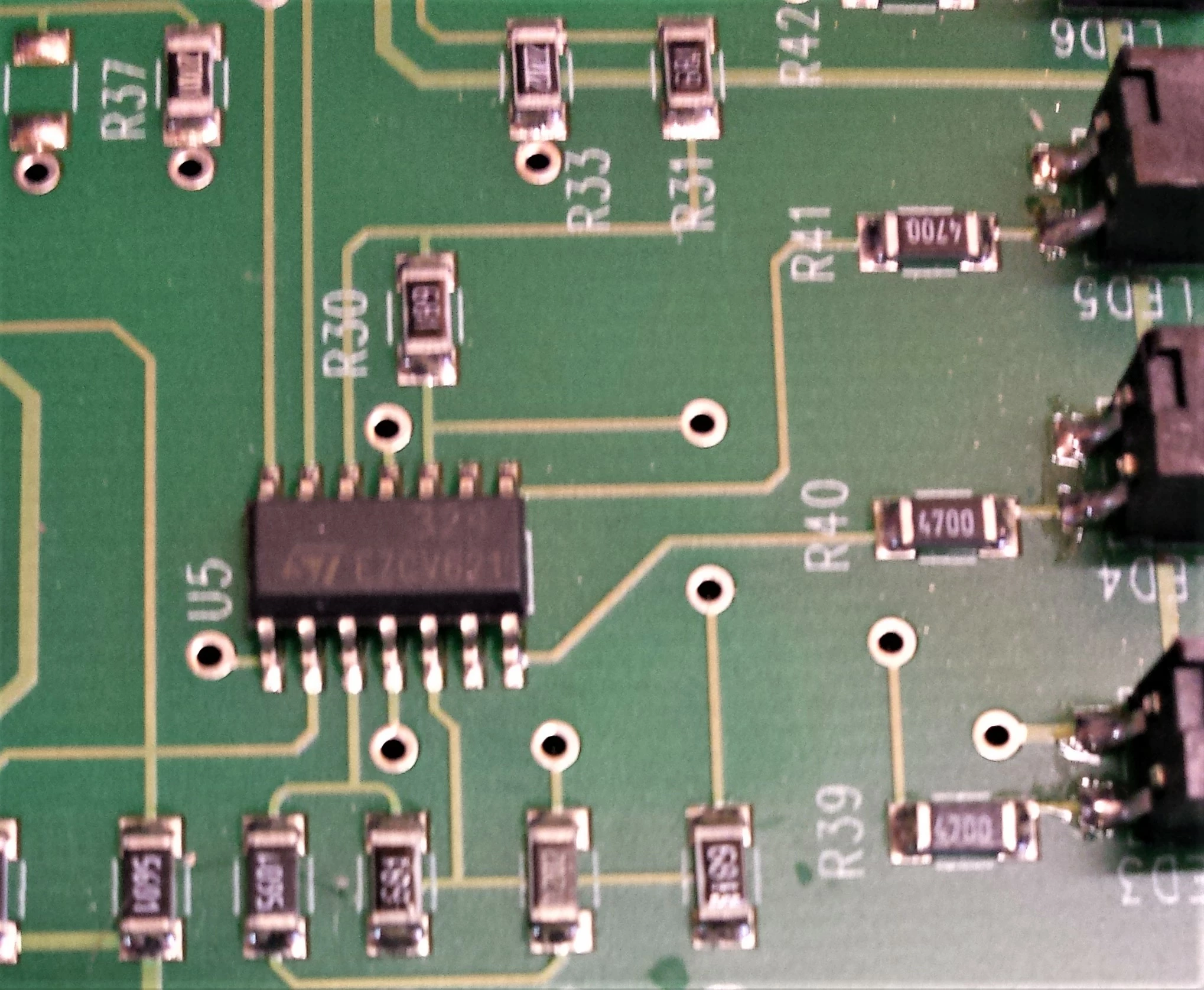

EZCV621 Level Meter LED driver, i need the Datasheet
Please, anyone has EZCV621 IC Datasheet?

Hi, RROSS.1,
you accidentally confused the date code with the type number. Your device is the LM324DT, which is available and not obsoleted.

Please include a detailed photo of this device.

0693W000006HWiIQAW.jpgHello, Peter, many thanks for the prompt Answer. this is the Device.
Greetings from MESTEC GmbH, Bayern, Germany

Perfect, many thanks, Peter. I had this doubt that´s an op-amp ( we haven´t unfortunally any Schematic Diagram of the Unit) now i´m shure.
