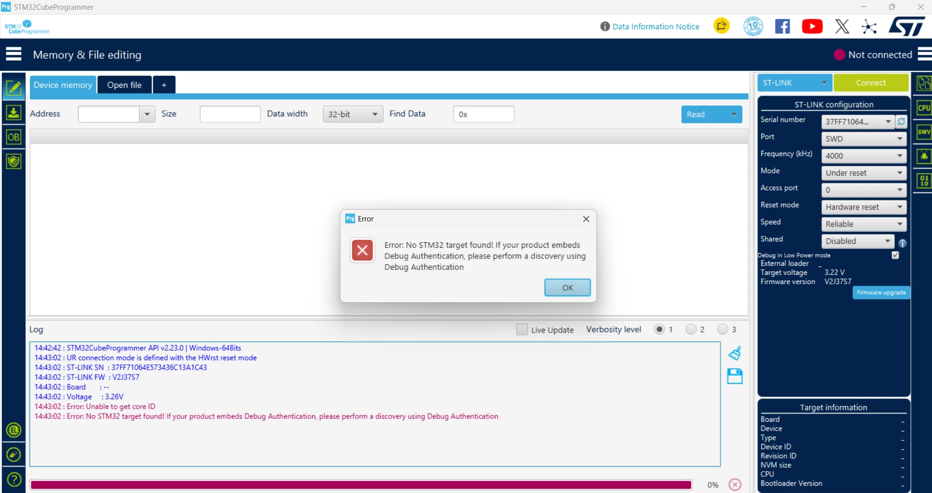

Error: No STM32 target found! If your product embeds Debug Authentication, please perform a discovery using Debug Authentication
I am using STM32F411CEU6 Black Pill from WeAct. Stlink was working I was able to flash the code but now after testing when I tried to connect it wouldn't connect I keep getting this error. I am using stlink clone.
USB under DFU mode gets connected, full chip erase works but when I try to flash the code I get this error
Please help me out

AScha.3
Jul 24, 2026 9:53 AM UTC
The STM32F411CEU6 is probably genuine by ST.
Try connect in mode: normal + software reset.
(As the sticks/clones have no working hardware reset !!! )

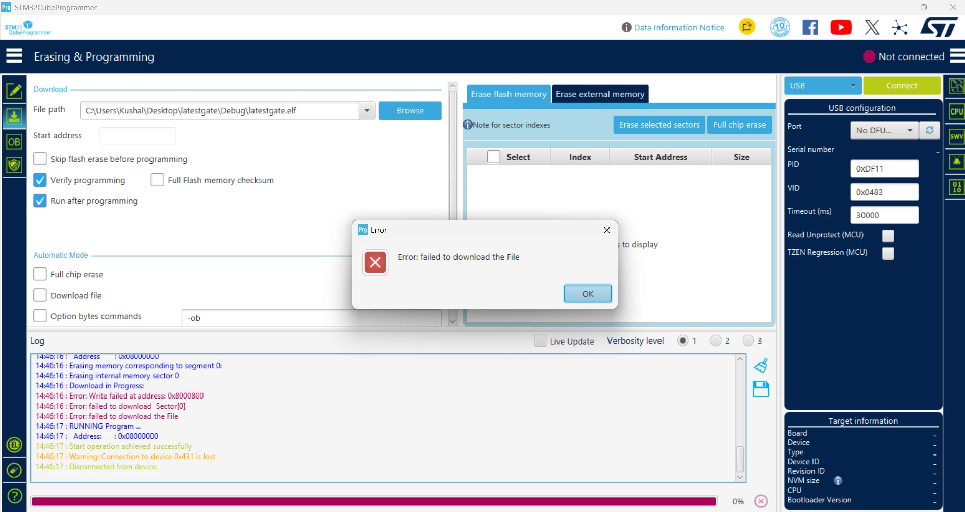

Hi thanks for the reply,
I was able to flash the device with the clone stlink 3 hours ago but now I am not able to do it.
Have you tried with a genuine ST-Link, or other known-good debug probe?
I dont have a genuine stlink
I tried the hardware reset from cubeprogrammer -
hold and press nrst button
connect
release nrst
it still didn’t work
Even if stlink is showing issue what about the usb dfu method? I’m getting download failed error.

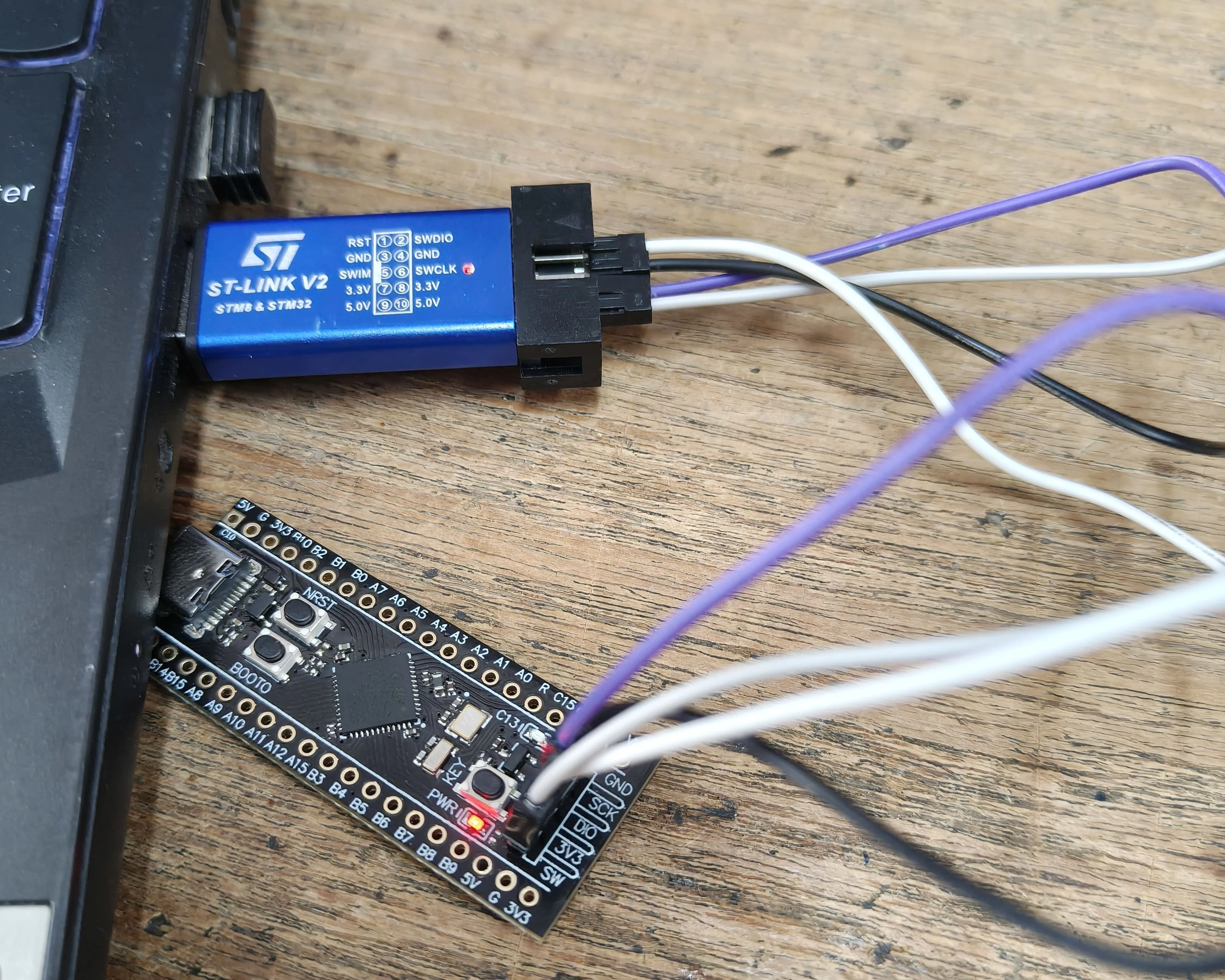

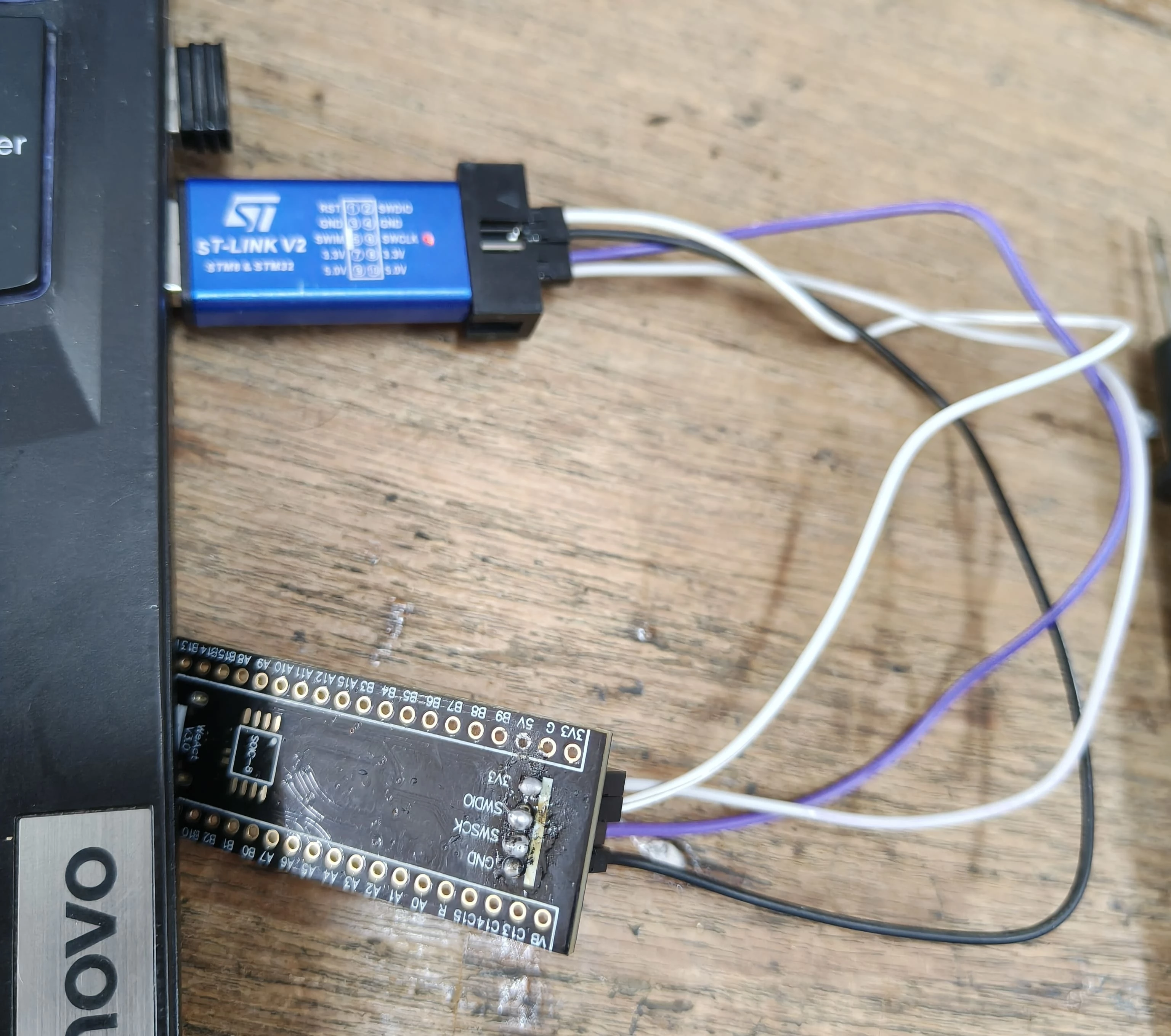

Andrew Neil
Jul 24, 2026 10:00 AM UTC
So what did you change in those 3 hours?
In particular, have you added low-power and/or reconfigured the SWD pins.
Intermittent working could be a sign of poor wiring connections - please show some good, clear photos of your setup.

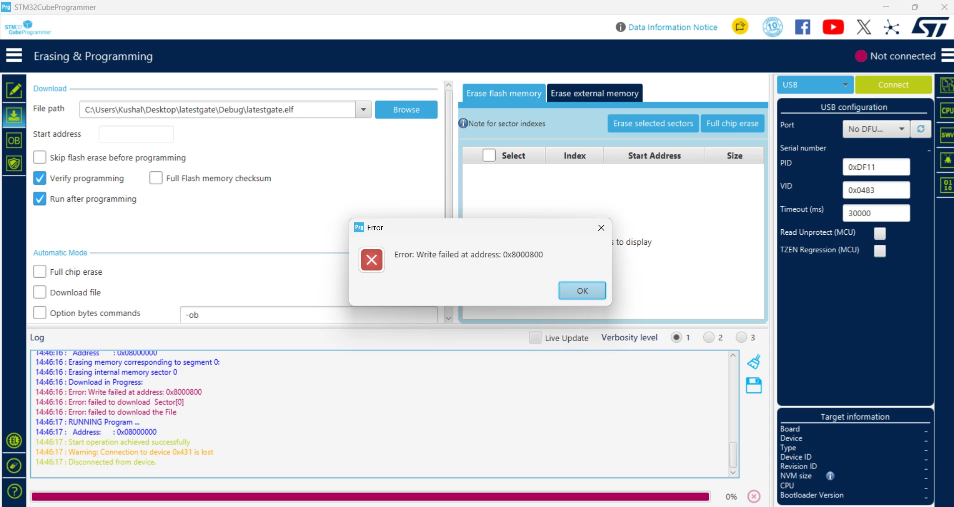

Has that method ever worked for you ?
Jul 24, 2026 10:18 AM UTC
All I did was note down the readings from the pins(A0,A1,A2,A3,A4) I had configured using multimeter. I made sure I didn't touch neighbouring pins.
I didn't try with usb dfu before since this is a new board which I bought yesterday since I was able to flash with stlink I just continued with it. When stlink failed I tried the dfu method but even that failed.
