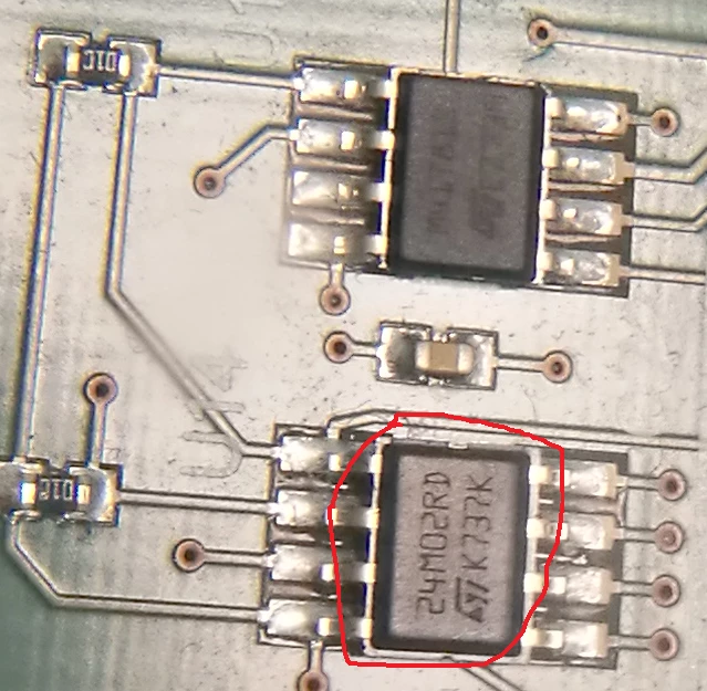

I'm facing a problem to get the eeprom working since whenever i try to write a page (256 bytes) or partial page with HAL_Mem routines the read function seems to read at the beginning wrong informations.
First of all i wish to clarify what eeprom code i've got on my board. In the figure below i'm seeing 24M02RD but the right name should be 24m02DR. Why? is the code correct? What does k737k mean?
As you can see the SCL and SDA lines are pulled up with 10K resistors and the bus is shared among several devices where everyone has its own unique address.
The device is supplied with a 3v3 voltage and uC used is STM32F429ZI. A2 phisycal address is tied to VSS.
Clock speed is 100000 and APB1 is 42MHz APB2 is 84MHz .
Before talking about my problem i want to say that during the tests the device has always answered with ACK and i2c peripheral had never got stuck with busy or hal_error codes. Furthermore the waveforms seems to be perfect with longer time than the eeprom datasheet requirements. (Unfortunately i can't attach the image here)

737 might be the datecode for 2017 week 37... the rest no clue.

​Hello,
Confirmed:
  • 2Mb I2c is a 256 bytes page.
  • 24m02RD is the good top marking
Warning with the pull-up value. 10K seems high to respect RC constant (see Figure 12 on datasheet  https://www.st.com/content/ccc/resource/technical/document/datasheet/b7/de/9b/f6/03/28/4e/8e/CD00290537.pdf/files/CD00290537.pdf/jcr:content/translations/en.CD00290537.pdf )

enricoricci51
April 24, 2019
Just now i've measured a rise time of 1.2 us in both lines SCL and SDA. Could it be the reason of problem?
Thanks
Pierre P.
April 24, 2019
​Should be ok at 100KHz.
