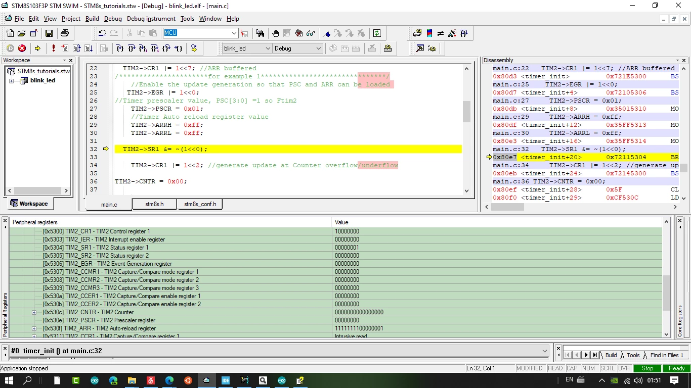

I am trying to generate a delay in STM8s103 using Timer peripheral TIM2.
but on equating the values to the Prescaler register(PSCR) and ARR. that is not happening
like I debugged my code step by step and on seeing the values of TIM2 registers, they are not loaded with assigned values. below is oic for it.
I am running my MCU at 2MHZ HSI and then using the PSC value for TIM2 be 1 so that my TImer frequency is 1MHZ and then generating delay of us, ms, and sec by using these functions

#include <stm8s.h>
void timer_init(void)
TIM2->CR1 |= 1<<7; //ARR buffered
//Enable the update generation so that PSC and ARR can be loaded
TIM2->EGR |= 1<<0;
//Timer prescaler value, PSC[3:0] =1 so Ftim2
TIM2->PSCR = 0x01;
 //Timer Auto reload register value
TIM2->ARRH = 0xff;
TIM2->ARRL = 0xff;
TIM2->SR1 &= ~(1<<0);
TIM2->CR1 |= 1<<2; //generate update at Counter overflow/underflow
TIM2->CNTR = 0x00;
CLK->CCOR |= CLK_CCOR_CCOEN | CLK_CCOR_CCOSEL;
