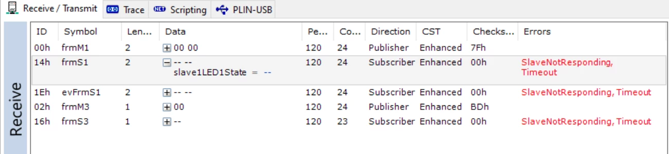

    Hello, Thank you for your response.
    I connected it as you have said it seems that it works but...
    I've downloded in it the project from the st website "STM8A-DISCOVERY boards firmware package, including LIN communication (AN4101)", but when I try to send and receive data from peaklin it gave me always "slave not responding, timeout".
    I don't know if I am missing something, could you please help me.
    Thank you.
    Kind regards.
    ZElya.1
    ZElya.1Author
    June 15, 2022
    I will add here more information about the debugging, it seems that the data sent from the master is received correctly, and the function "USART_SendData8" responsible of sending frame from uc to the master is executed but i still get "slave not responding, timeout"
    I am confused Idon't know where the problem is !
