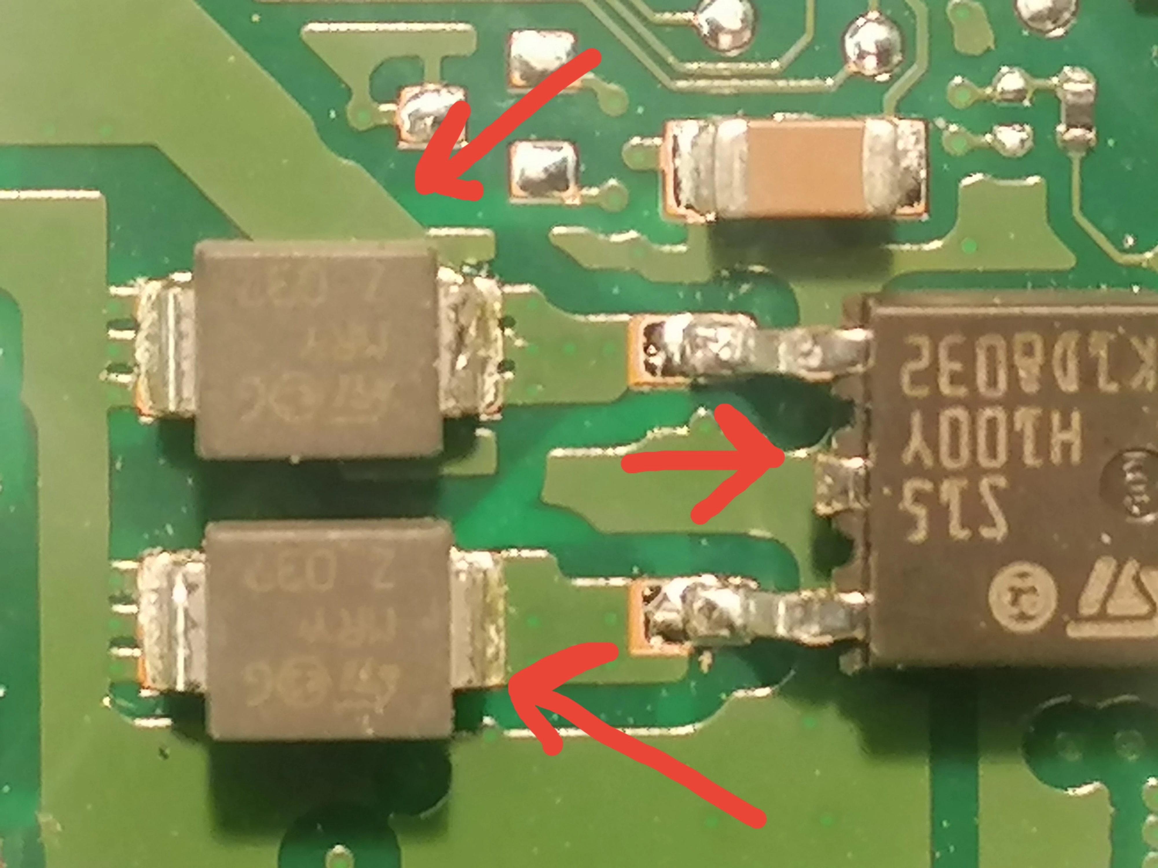

could not define this component
could not find the part number for this component (Left Arrows)
for the Right arrow, is it schottky?

Welcome @Hatyy, to the community!
It looks like you're investigating an automotive device right now?
As suspected, the DPAK on the right is the Dual Schottky Diode STPS15H100C-Y and the two SMB on the left are the SM6T30CAY.
