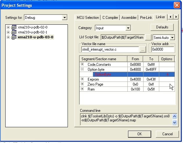

    Hello all !
    I'm trying to preinit my MCU's OPTION_BYTE to create a binary with the OPTION_BYTE allready set !
    This work fine with a assembly file in Ride7 with raisonnance compiler, but now i'm trying to do the same thing with ST Visual Develop and Cosmic compiler but I don't work !
    Of course a find pseudo-solution, but I want a solution without modifying the linker command file (this isn't a profesionnal solution !)
    I don't agree with the other solution trough STVP, because my code will be shared I prefer something in a assembly file or C source to avoid mistake instead of a extra manipulation ! And I prefer something who work in debug mode too !
    Please help me !

    Thanks but I found by myself what i'm looking for !
    Here is my code :
    #pragma section const {OptionByte}
        const struct OPT_struct OPTION_BYTE = {0x00, 0x00, 0xFF, 0x02, 0xFD, 0x00, 0xFF, 0x00, 0xFF, 0x00, 0xFF, 0x00, 0xFF, 0x00, 0xFF};
    #pragma section ()
    You need to add this new section in your lkf file, forget hand modification, goto Project -> Settings -> Linker -> Category : Input
    Add a Segment and add a sub section, enter address of start and end.
    Set the option of the section to -k to avoid linker optimisation, the linker will keep this unused section.
    The final binary fille will include the OPTION_BYTE set according to your need !
