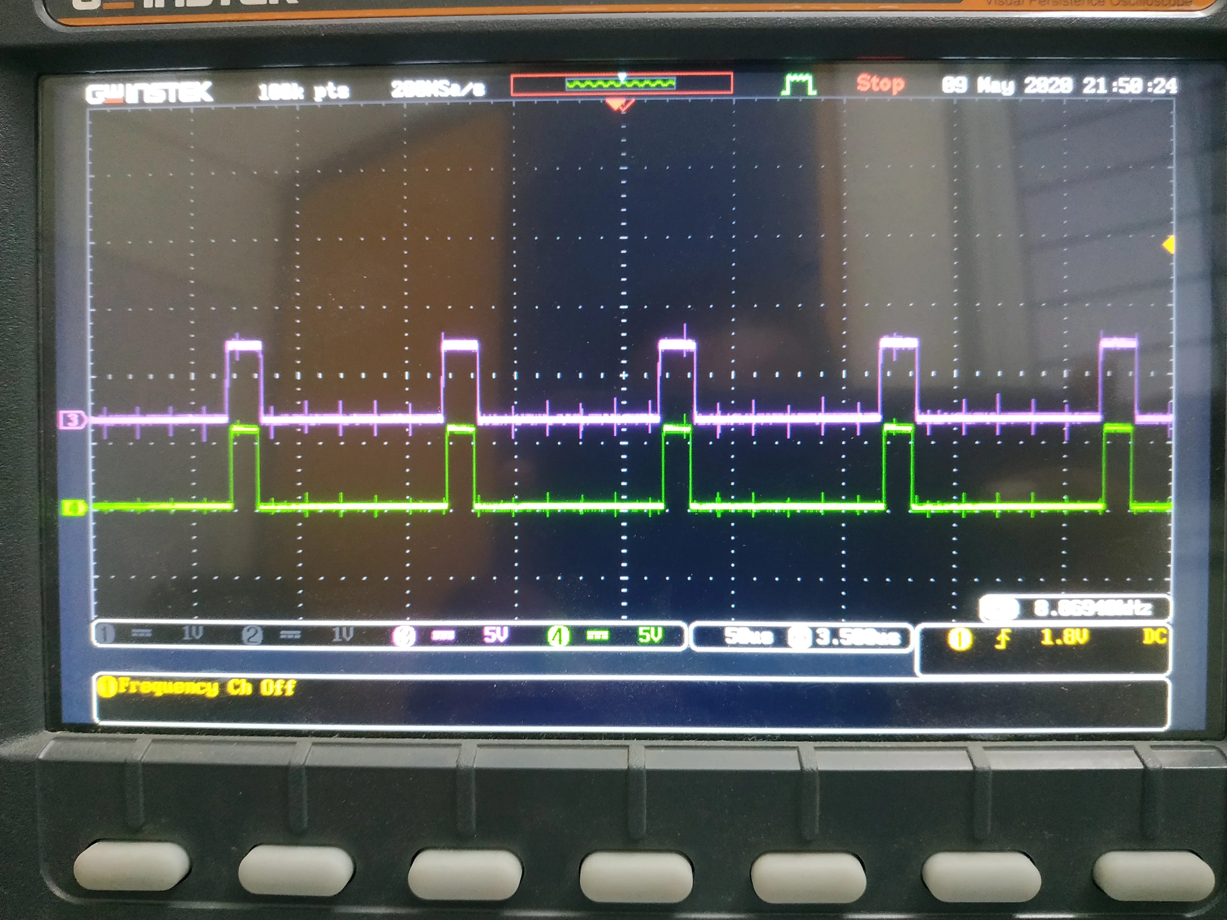

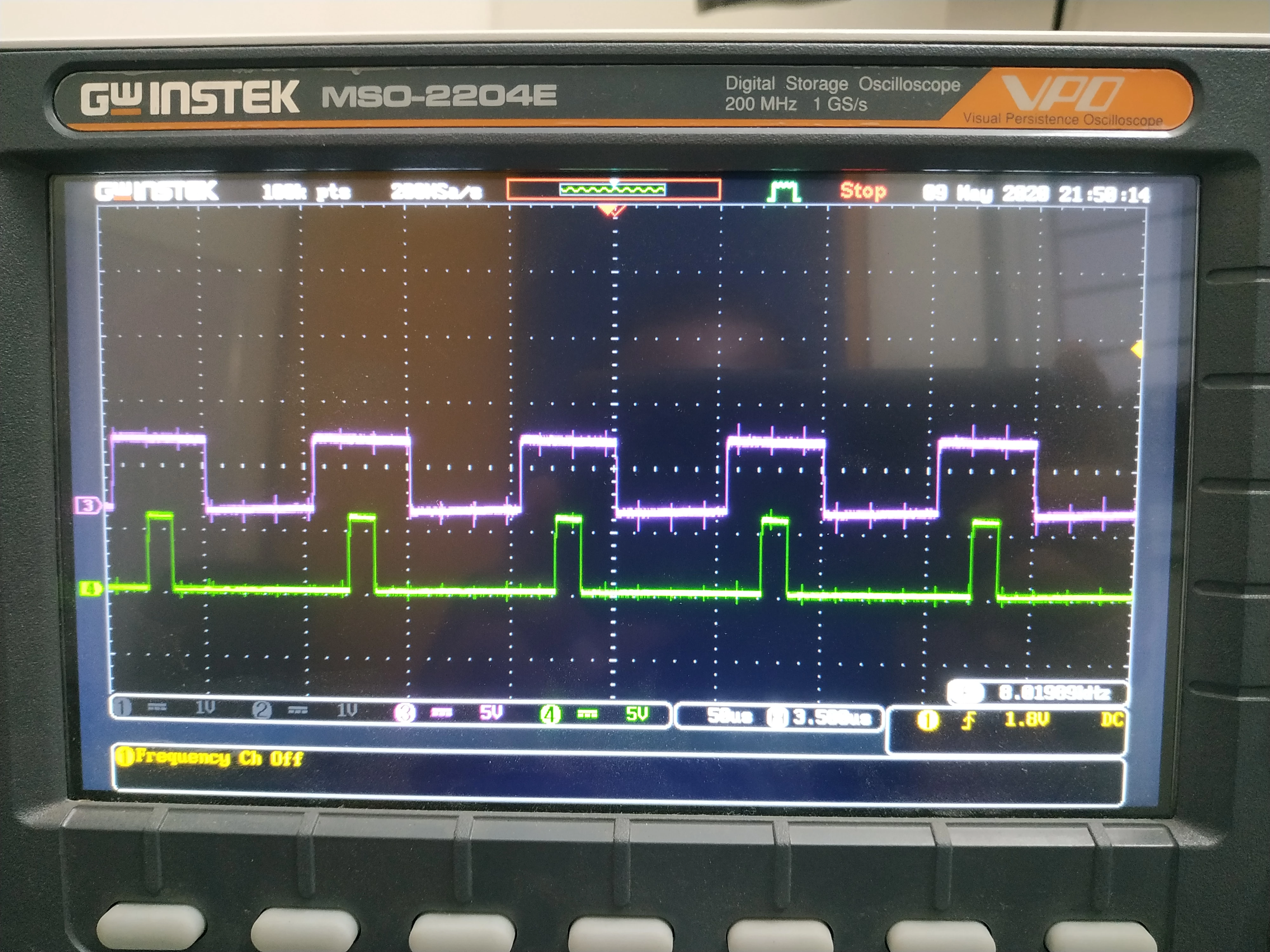

Complementary PWM not working for STM8S105 MCU
Here is the initialization code...
void InitPwm(void)
TIM1_DeInit();
TIM1_TimeBaseInit(0, TIM1_COUNTERMODE_CENTERALIGNED1, 800, 0);
TIM1_OC1Init(TIM1_OCMODE_PWM1,
TIM1_OUTPUTSTATE_ENABLE,
TIM1_OUTPUTNSTATE_ENABLE,
100,
TIM1_OCPOLARITY_HIGH,
TIM1_OCNPOLARITY_LOW,
TIM1_OCIDLESTATE_RESET,
TIM1_OCNIDLESTATE_SET);
TIM1_OC2Init(TIM1_OCMODE_PWM1,
200,
TIM1_OC3Init(TIM1_OCMODE_PWM1,
300,
TIM1->DTR = 0;
TIM1_CtrlPWMOutputs(ENABLE);
TIM1_ClearITPendingBit(0xFF);
TIM1_ITConfig(TIM1_IT_UPDATE | TIM1_IT_BREAK, ENABLE);
TIM1_Cmd(ENABLE);
@near @interrupt void PWM_Isr (void)
if ((TIM1->SR1 & TIM1_IT_BREAK) == TIM1_IT_BREAK) //Break Input active
TIM1_ClearITPendingBit(TIM1_IT_BREAK);
if ((TIM1->SR1 & TIM1_IT_UPDATE) == TIM1_IT_UPDATE) //Overflow/Underflow
//duty change code to go here
This code compiles and PWM is visible on High side channel (OC1, OC2, OC3). However, the PWM on Low side channel (OC1N, OC2N, OC3N) keeps on varying. Sometimes, it's exactly complementary to it's High channel but sometimes it fluctuate randomly.
Please let me know how to solve this problem.
Waveforms are attached as images...
Green - OC2 pwm, High side channel, configured as active high - waveform As expected
Pink - OC2N pwm, Low side channel, configured as active low - waveform as expected in ExpectedPwm.jpg, and random/varied/unexpected in UnexpectedPwm.jpg
