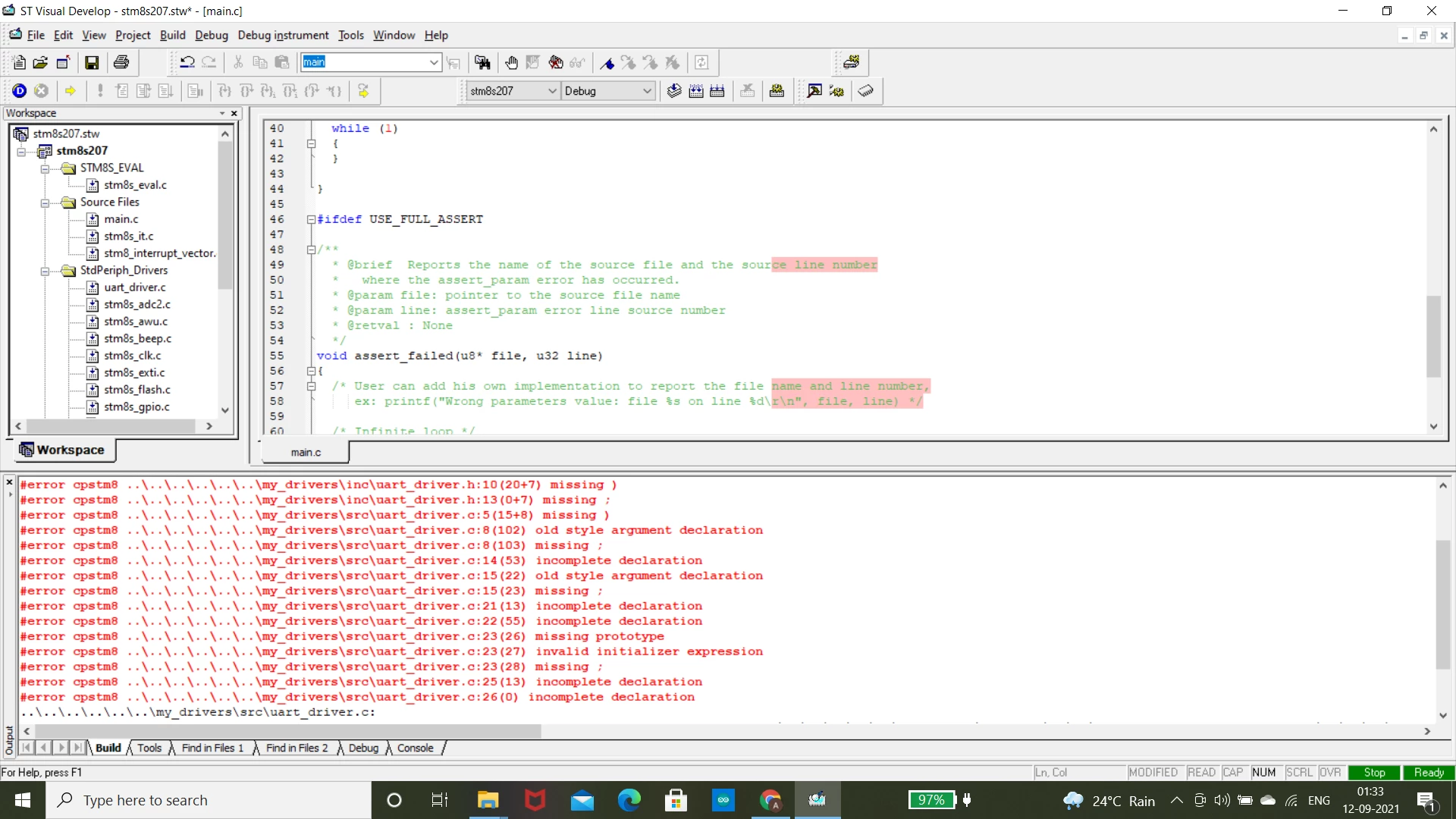

I am a student who has recently started working with STM8s MCU's. Currently I am working with an STM8s207K8 Nucleo 32 development board, I am using STVD along with a cosmic toolchain to program my dev board. I am able to program the microcontroller successfully using the standard peripheral library, however when I am trying to create a custom driver the compiler throws an error stating that it can not open the specific header file, this happens when I try to add the inc and src files to the the already existing SPL files, and when I create a new folder of custom drivers and create two sub folders for inc and src files the compiler throws around 15 errors, I am attaching screenshots of the error here and also pasting the header and source files of the custom UART driver that I am trying to create.

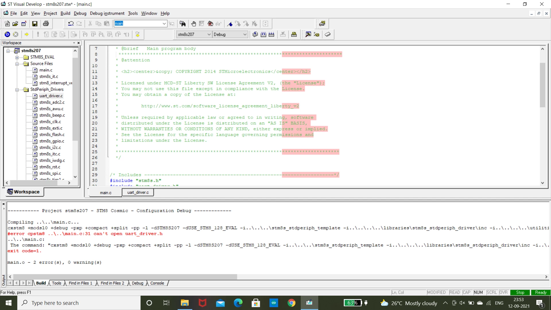

    Best answer by APant.1
    Hi, I have identified the problem and deployed a solution as well now. All the paths were set up correctly, and I tried using the library in the specified form as well but it was not successful, apparently you have to include the stm8s.h library in your header file as well as in your main c code. I suppose the #include "stm8s.h" file also acts as the board specific header file, the absence of which in the uart_driver header file was causing a compilation error. I have tested this by creating another driver for clock configurations and delay functions which are also working fine. Thanks for your help though it gave me the necessary idea to guide me to a particular solution. I will paste the code along with this message here so that someone else who might be struggling with this issue can find a solution and refer to the code as example.

    Start with the first error
    Perhaps make sure you #include all the definitions and libraries the code in your uart_driver.c needs

    Hi I included the #include "stm8s.h" library in the uart_driver.c file however is is still showing one of the same errors which it was displaying yesterday, that is compiler can't open uart_driver.h. Another issue that I noticed was that once I compiled the code the uart_driver.h file disappeared from the External Dependencies folder.0693W00000Dmv1xQAB.png
