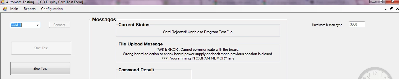

hello guys
I am new to this forum and I want to ask the solution for one of the problem which I encountered during the testing of my STM 8 microcontroller board.
Actually I was testing the board and than during the testing I encountered this problem:
Check the SWIM cable connection and check all the needed pin connections on the SWIM connector.
I have attached the snapshot of error too for analysis of exact problem.
Now I want to know why I am getting this error and what is the solution to it.
Thank you

    There are four connections required for swim interface VDD, GND, SWIM and reset. Pls check the connectivity for all the four pins from debug intrument to micro.
    I hope it will help.

    In my Swim connections actually there are three pins one is connected to the pin 18 of the SWIM pin of the microcontroller ND THAN MIDDLE ONE  to the reset pin 4 of the micrtocontroller and last one with the gnd. there are no four pins and I am using this microcontroller:
    STM8S103F2P6
    But still I am gettitng the error and I have double checked the connections all connections are perfect from the multimter testing and are showing the connectivity.

    I think you need to connect VDD from your target to the SWIM
