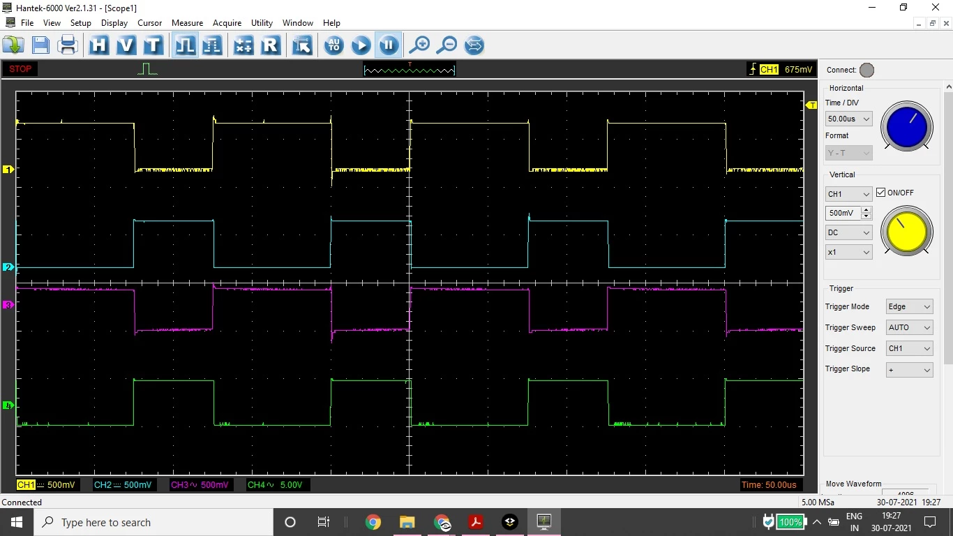

iam using stm8s003f3 microcontroller i configured centeraligned pwm but not working
attached wave form also please suggest.
