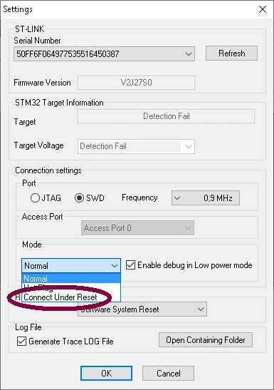

CANNOT FIND "Connect Under Reset" option in the Target -> settings menu in the STM32 ST_LINK utility. The primary problem is that i cannot connect my st_link to the utility. I have aready updated the firmware

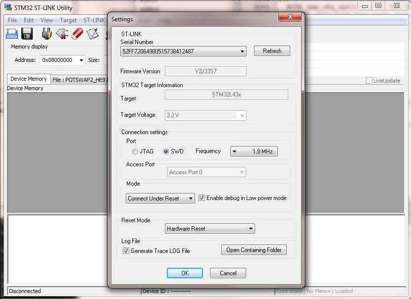

    waclawek.jan
    May 22, 2019
    Target->Settings, a Settings window opens:
    G.M.
    G.M.Author
    May 22, 2019
    I haven't that option on the list, i only have Normal and Hot Plug options
    G.M.
    G.M.Author
    May 22, 2019
    And i also can't modify the frequency in the port configuration section

    It find ST-LINK, version V1, i am using an stm8s discovery demoboard
