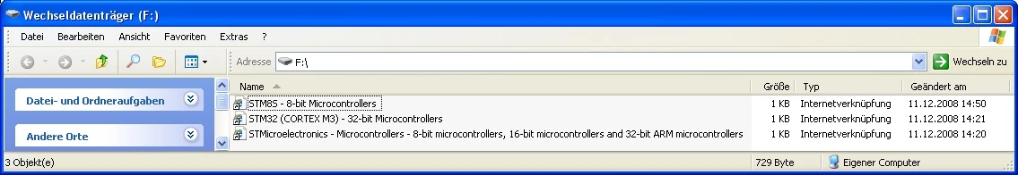

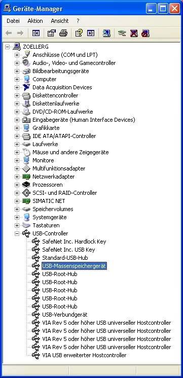

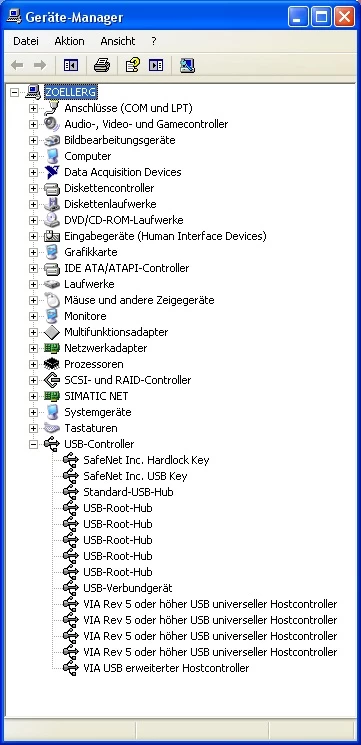

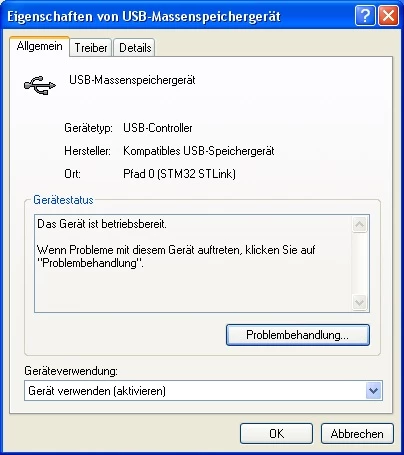

Georg Zöller
Visitor II
Dec 12, 2016 1:36 PM UTC
Posted on December 12, 2016 at 14:36

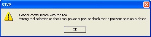

I also have the problem.
I downloaded the program, registered and then installed it.
This error message then comes ''Cannot communicate with the tool.
Wrong tool selection or check tool power supply or check that a previous session is closed.''.
USB has detected the PC and I can not go any further.
From Result.log:
new log session
date:    12/12/16
time:    13:59:59
STVP_CmdLine version 1.6
NO ARGUMENTS GIVEN: will use default config. Type STVP_CmdLine -help for usage
Configuration:
BoardName=ST-LINK Device=STM8L15xC6 Port=USB ProgMode=SWIM
ProgMemFileName=ProgMem.hex
OptionFileName=Option.hex
Verbose ON
Log activity ON
Display Progress OFF
Message box warning if protect option byte ON
Loop mode ON
Erase device OFF
Blank check device OFF
Verify device ON
>>> Filling PROGRAM MEMORY image in computer with Blank Value
<<< Filling PROGRAM MEMORY image in computer succeeds
>>> Loading file ProgMem.hex in PROGRAM MEMORY image in computer
<<< Loading file succeeds
>>> Loading file Option.hex in OPTION BYTE image in computer
>>> Programming PROGRAM MEMORY
<<< Programming PROGRAM MEMORY fails0690X00000603L2QAI.jpg0690X00000603UrQAI.jpg0690X00000603UwQAI.jpg0690X00000603UsQAI.jpg0690X00000603V1QAI.jpg
Georg Zöller
Visitor II
Jan 6, 2017 7:45 AM UTC
Posted on January 06, 2017 at 08:45
Hello, I'm back again.
With the STM8-Discovery the connection has now folded.
I have connected the ST-Link / V2 and this has automatically installed the driver.
Then I connected the STM8-Discovery and lo and behold, it worked.
Thanks for your feedback!
