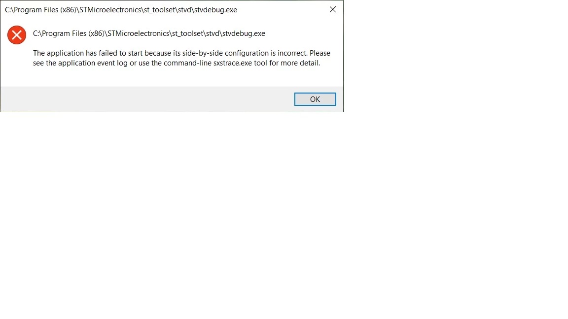

Can you explain this error ??

    Welcome, @Tcha.1​, to the community!
    Please do not install this software in the Windows standard paths that contain a space, but rather in a path such as C:\ST.
    Regards
    /Peter
    Piranha
    Principal III
    October 20, 2021
    In 21st century this is pretty ridiculous... And not only RN0013 doesn't list this as a known limitation, but it shows "Program Files" based paths as a good examples. ST should either fix it or at least document it as a known limitation.
