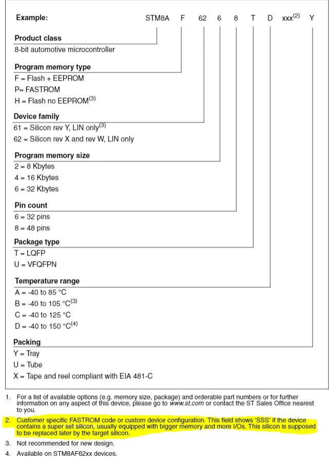

Can the device STM8AF6226TCY be replaced by the STM8AF6226TCSSSY?
  • August 16, 2022
  • 1 reply
  • 1021 views
Can the device STM8AF6226TCY be replaced by the STM8AF6226TCSSSY? Are they the same product? My customer wanted STM8AF6226TCY, but what we found was STM8AF6226TCSSSY.0693W00000QNmAeQAL.jpg

    Both materials are the same​
