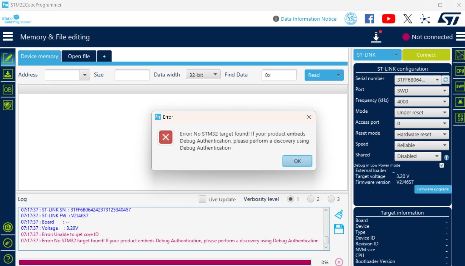

Sep 22, 2026 12:24 AM UTC
I’m using an genuine ST-LINK, which I have been using successfully to program an STM32F103C8T6 for about three months.
Recently, I tried to use the same ST-LINK to program an STM32F407-DISC1. However, the onboard programming/debugging port on the STM32F407-DISC1 is damaged, so I’m trying to connect the external ST-LINK directly to the SWD interface.
When I try to connect to the STM32F407-DISC1 using STM32CubeProgrammer, I get the error message shown in the attached image.
The same ST-LINK works normally with my STM32F103C8T6.
What could be causing this issue, and what should I check on the STM32F407-DISC1?

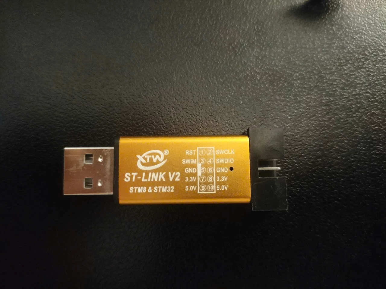

Again, there is no such ST product as an “ST-LINK V2 mini”.
So please post photos of the front & back of the device you have.

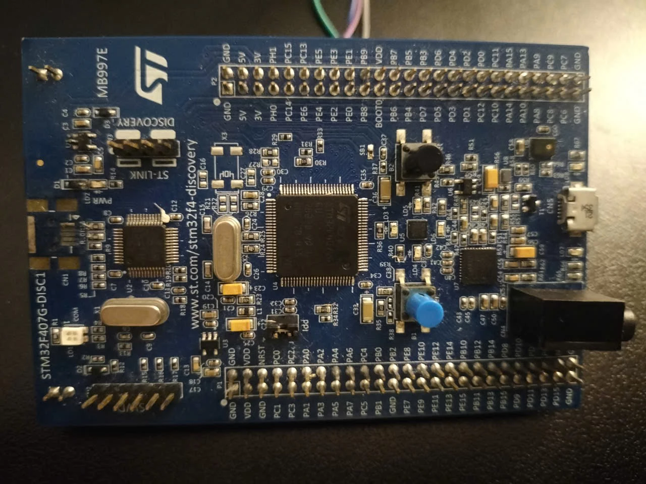

How do you know that?
How was it damaged?
How do you know that the target STM32F407 wasn’t also damaged?

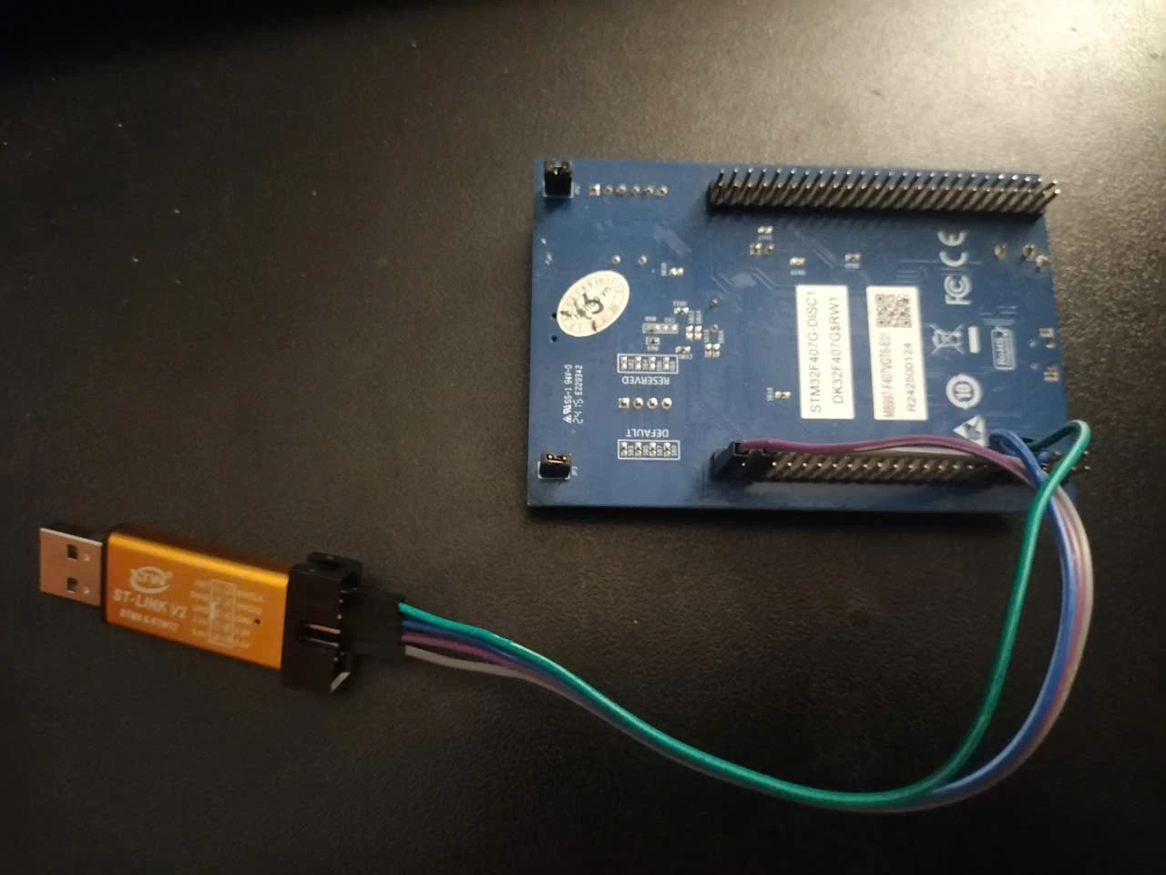

Anyhow, to use an external debug probe (whether genuine ST or not), you will first need to disconnect the onboard STLink - see the User Manual and/or schematics for details.
Please show how you are connecting your STLink to the Disco board - schematic, photos.

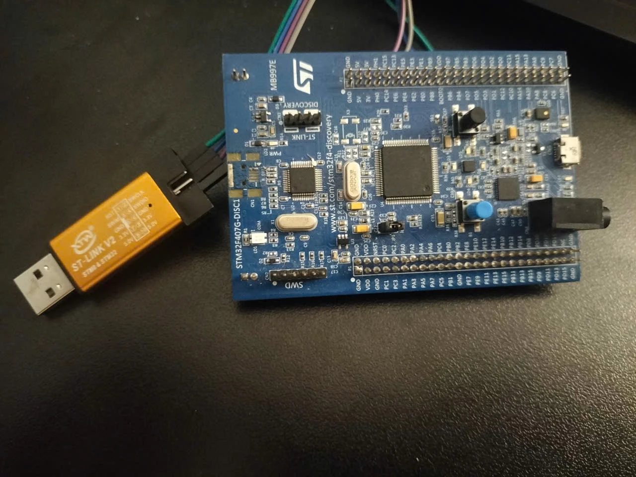

Sep 23, 2026 2:26 AM UTC
The first photo shows my ST-LINK.
The second photo shows my development board. As you can see, the onboard programming/debugging connector is damaged.
The third and fourth photos show the front and back of my wiring connection.
My connections are as follows:
  • PA14 (SWDIO) → ST-LINK (SWDIO)
  • PA13 (SWCLK) → ST-LINK (SWCLK)
  • GND → ST-LINK (GND)
  • 3V → 3.3V
After the programming/debugging connector on the board was damaged last month, I tested the connection using STM32CubeProgrammer, and it connected successfully.
However, I am still using exactly the same wiring and setup now, but STM32CubeProgrammer reports that it cannot find the STM32, as shown in my previous screenshot.
I don't know what happened or why it suddenly stopped working, so I would appreciate any advice on what I should check next.
ST-LINK
development board
Explorer II
Sep 23, 2026 5:37 AM UTC
‘XTW ST-Link V2’ is not a ST authorized debugger/programmer.
Or be more plain, IT’S FAKE.
SO WHAT IS A REAL, GENUINE ST-LINK???
https://www.st.com/en/development-tools/st-link-v2.html
IMO, never bring disgrace on yourself by asking for official support with a fake merchandise.
