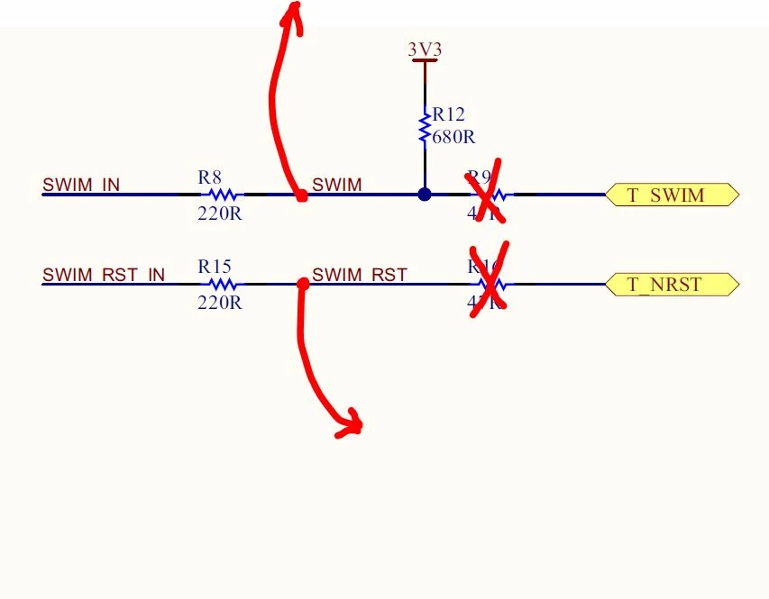

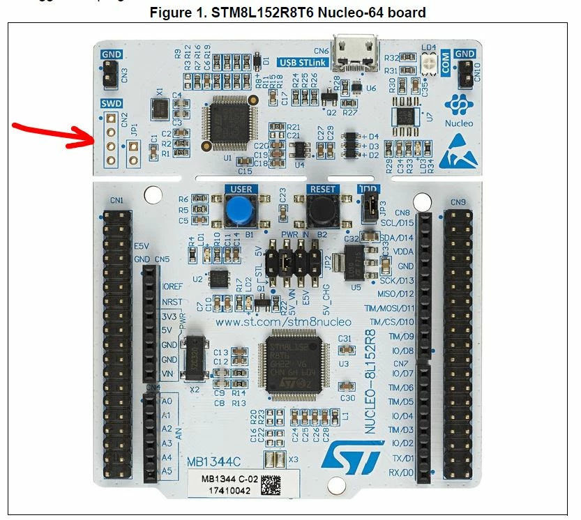

I know you can with the 32 bit nucleo boards but is it possible with the STM8L152R8T6 Nucleo-64 board? My feeling is no because the SWIM protocol requires VDD, SWIO,GND and RESET pins which i cant see anywhere in the ST-link section of the STM8L152R8T6 Nucleo-64 boards schematic. Hopefully someone can tell me I'm wrong though.

Hello TConl.1,
I do not own a STM8_Nucleo so no, I did not have that working. And also I mistook the CN2 connector for SWIM, it is SWD.
But you should be able to use the STLink for other STM8 controllers, after all you can snap it off from the Nucleo. That means that the SWIM and NRST signals are on the narrow connections between the STLink and the target-board.
I took another look at the schematic and saw that those signals are not easily available on a connector. You will have to do some soldering to remove R9 and R16, SWIM and NRST then are no longer connected to the STM8 on the target-board and you can use them for an external mcu. Not very nice from ST...

Hi @Community member​  have you managed this? The SWIM protocal uses vdd, gnd, reset and swio lines but the pinout of that header you point to shows vdd, gnd, clk and swio. I tried with just the power and data lines but stvd couldnt find the target.

@Community member​  yeah the CN2 connector seems a bit useless - not sure how the SWD connections are any use to me.. Thanks for the info was hoping I was just missing something but it does seem like a real pain. The nucleo for some 32 bit boards seem to be much easier to use to program other boards but again seems to just be for the specific chip on the board it comes with.
