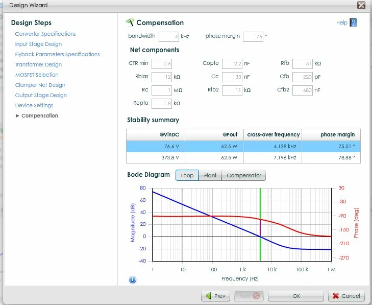

Hy,
can i change opto CTR and so on?
0690X00000AQyFIQA1.jpgregards Tiziano
Best answer by Patrizia BELLITTO
you can change the CTR min value visible as first field in the Net components form.
Best regards,
Patrizia Bellitto
Best regards,
Patrizia Bellitto
