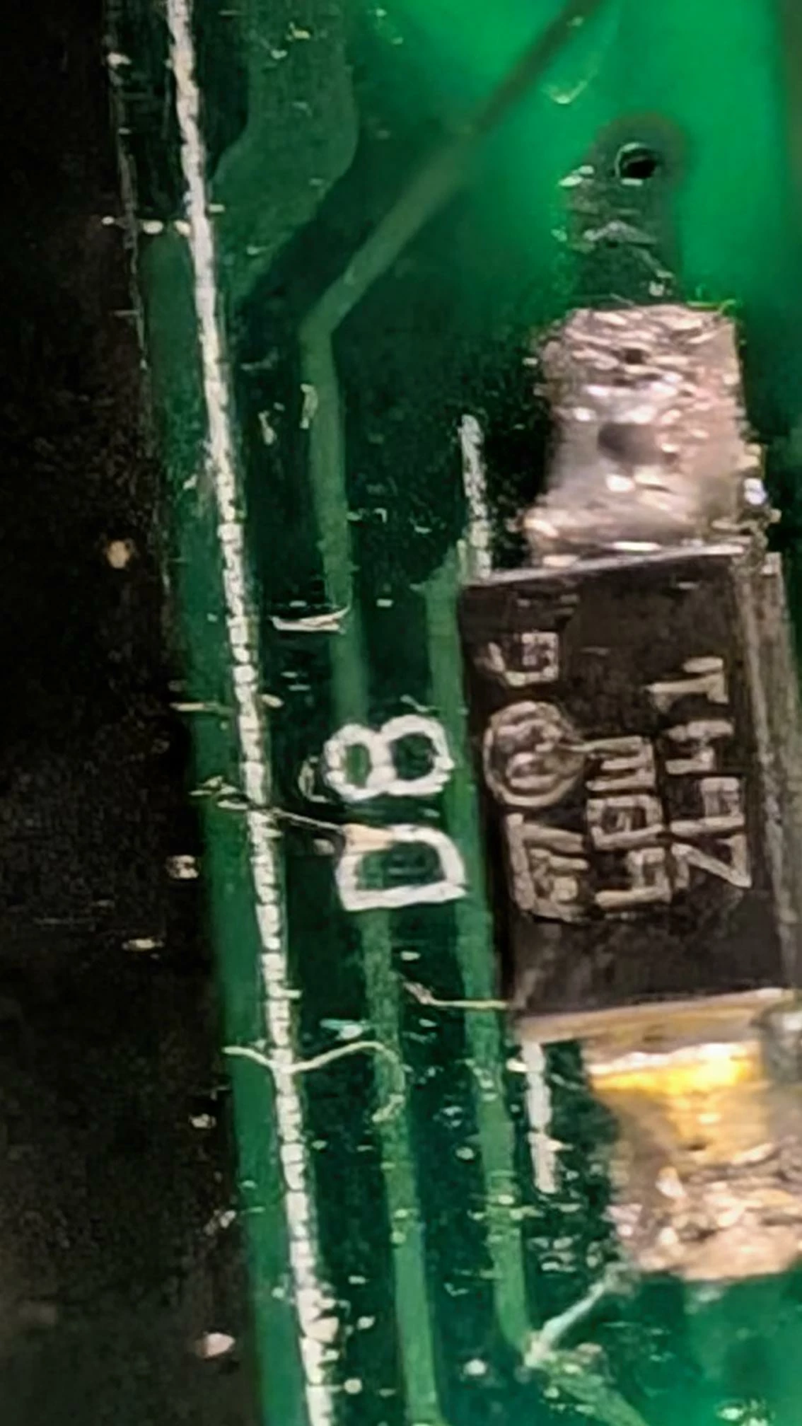

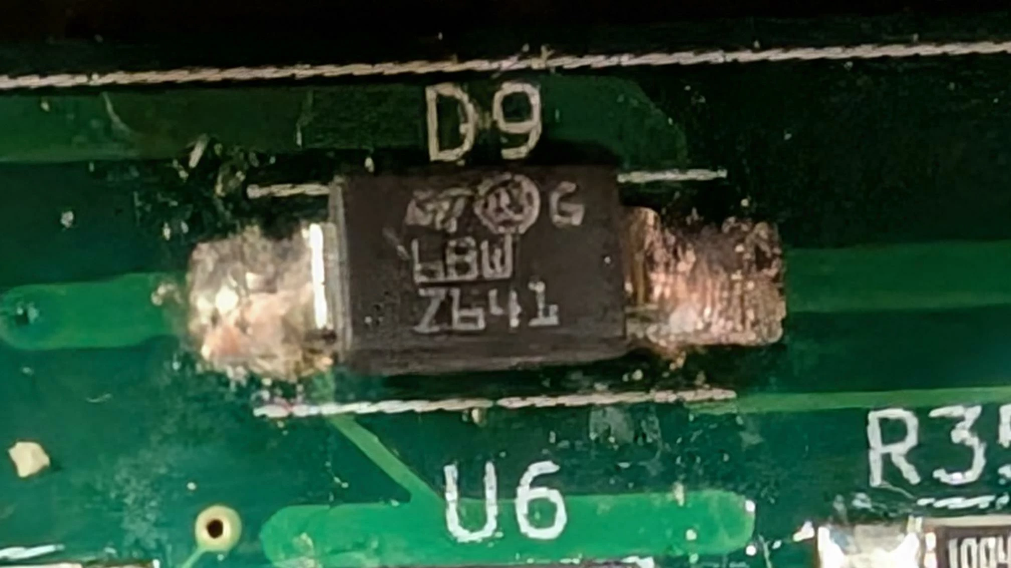

Can anyone identify this diode?
Can anyone identify this diode? I am looking to purchase a replacement but am unsure of the specifications. Media (3).jpegMedia (2).jpegMedia (1).jpeg

SMA6F30A
Datasheet - SMA6FxxA - 600 W TVS
No longer manufactured, but should be easy to find something equivalent.

DigiKey has a Vishay SMA6F30A-M3/H
https://www.vishay.com/docs/89458/sma6f5.pdf
