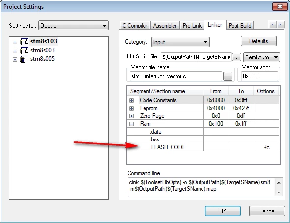

[STVD + COSMIC_C : STM8S103K3]
I want to use prototype function
which need EXECUTION_FROM_RAM.
after i  build.. It ERROR..!!
help me please..  T_T!

Step 1 , 2 , 4 and 5 , i make done.
but i confuse step 3..
3- In STVD Select Project\Settings\Linker\Category ''input'' and in the RAM section
    add the FLASH_CODE segment with ''-ic'' options
[url=http://www.uppic.org/share-479C_579BEACC.html][img]http://www.uppic.org/image-479C_579BEACC.jpg[/img][/url]
when build..
clnk -l''C:\Program Files\COSMIC\FSE_Compilers\Lib''  -o Debug\stm8s103.sm8 -mDebug\stm8s103.map Debug\stm8s103.lkf
&sharperror clnk Debug\stm8s103.lkf:1 segment .FLASH_CODE size overflow (161)
 The command: ''clnk -l''C:\Program Files\COSMIC\FSE_Compilers\Lib''  -o Debug\stm8s103.sm8 -mDebug\stm8s103.map Debug\stm8s103.lkf '' has failed, the returned value is: 1
exit code=1.
stm8s103.elf - 3 error(s), 0 warning(s)
How do i solve this problem..?
