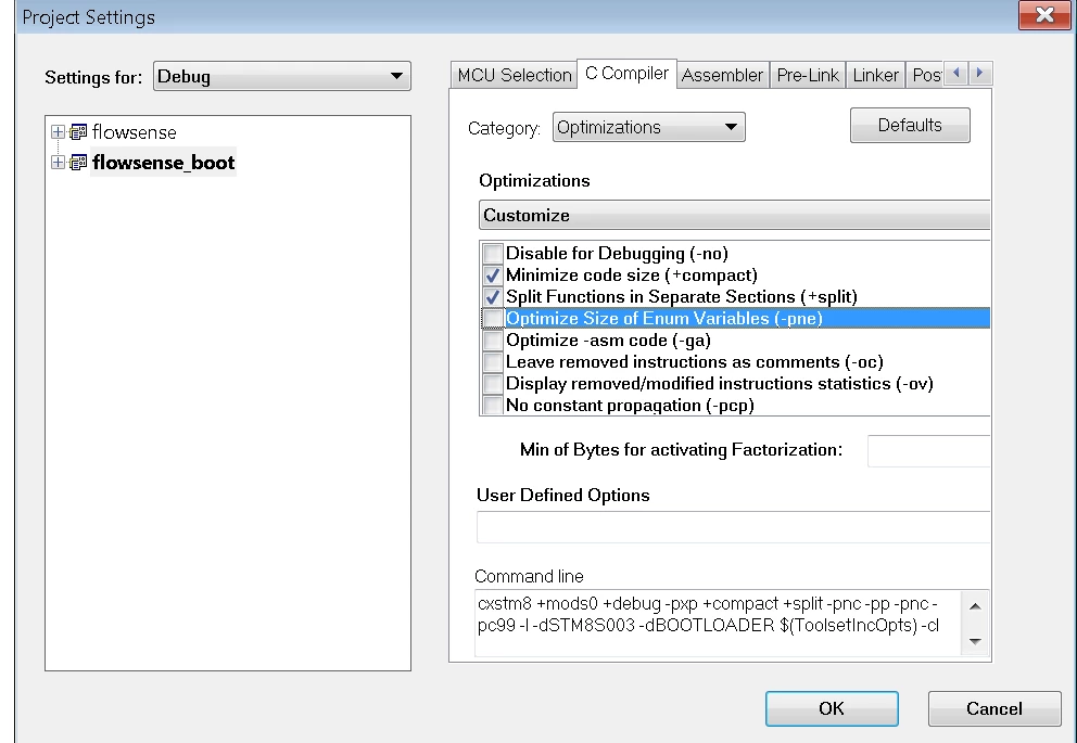

[Bug report]STVD inappropriate description of the Cosmic's -pne compiler flag
  • June 15, 2018
  • 0 replies
  • 828 views
Posted on June 15, 2018 at 10:42
The STVD calls it ''Optimize Size of Enum Variables''
However it does the opposite:
The Cosmic support said:
We checked your problem and by default, the compiler sets enum in 8 bit wide when possible. We suspect that STVD may have set a compiler option: -pne (no enum optimization).
