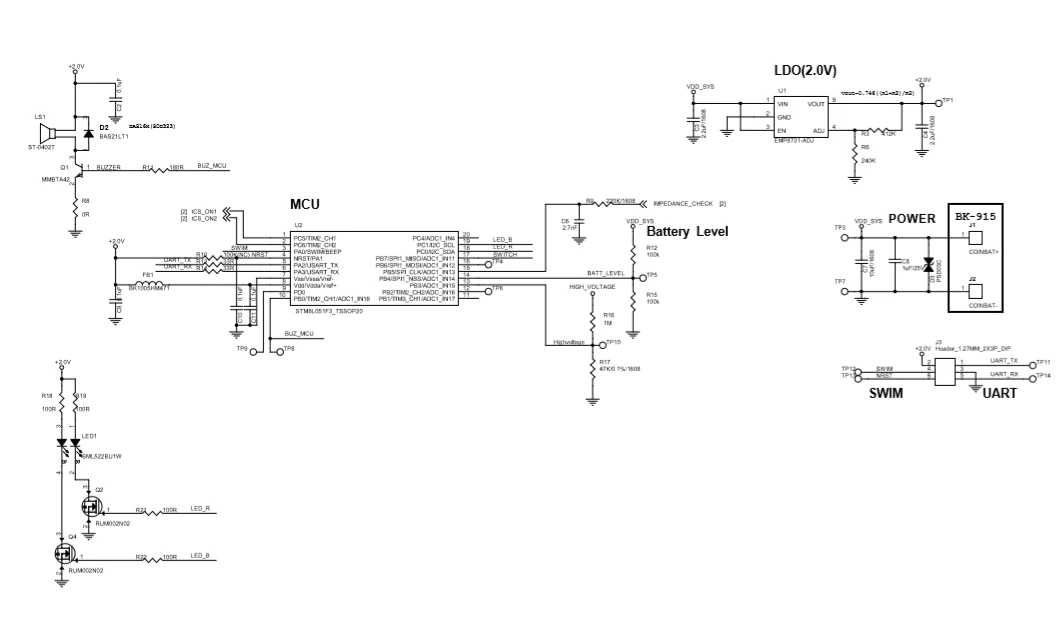

I need your help to find out the root cause of my issue,
please help to check the issue, thankful for your support in advance,
thanks.
issue,
when trying to do bring-up new board, we can't control any port related with LED.
Chip is STM8L051F3, used with STVP, IAR embedded workbench IDE - stm8
I can download hex file, but the symptom seems to be that CPU is no responsive, at all.....
please refer my code, I used STM8L15x_StdPeriph_Driver SDK,

    What is behind your definitions: LED_R_GPIO_PORT, LED_R_GPIO_PINS,LED_G_GPIO_PORT, LED_G_GPIO_PINS.
    Are you using internal default clock or some external crystal.
    May I ask you for a part of the schematics with visible power pins, NRST, SWIM connector, please?
    Thank you in advance

    edmond yun
    Jun 27, 2018 3:03 AM UTC
    Posted on June 27, 2018 at 03:03
    Hello, Artur, ,
    Thankful for your concern, ,
    I update the schematic, and more description for your questions, please refer it and give me your guide,
    ♯ define LED_R_GPIO_PORT GPIOC
    ♯ define LED_R_GPIO_PINS GPIO_Pin_0
    ♯ define LED_B_GPIO_PORT GPIOC
    ♯ define LED_B_GPIO_PINS GPIO_Pin_1
    I am using internal clock and tried to change from 2 Mhz to 16 Mhz...with the following code,
    But I can't see LED light in all case, the output voltage of LEDs is zero....
    For 2 Mhz case(default case),
    CLK_SYSCLKDivConfig(CLK_SYSCLKDiv_1),
    For 16 Mhz case, ,
    // CLK_SYSCLKSourceSwitchCmd(ENABLE),
    // CLK_SYSCLKSourceConfig(CLK_SYSCLKSource_HSI),
    // CLK_SYSCLKDivConfig(CLK_SYSCLKDiv_1),
    // while (CLK_GetSYSCLKSource() != CLK_SYSCLKSource_HSI)
    // {}0690X0000060LUPQA2.png
    thanks.

    Jun 27, 2018 10:10 AM UTC
    Posted on June 27, 2018 at 12:10
    The problem is related to the fact that PC0 and PC1 are true open drain (no internal pull-up nor high side transistor in output configuration). To make it working you need to add external resistors.
    Please have a look at datasheet into pins specification for more information.
    Best Regards,
    Artur

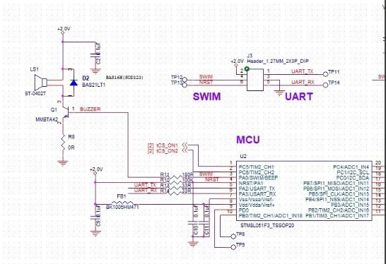

    edmond yun
    Jun 27, 2018 12:31 PM UTC
    Posted on June 27, 2018 at 14:31
    today I got some progress, currently we can download binary image with IAR(Download and Debug function),
    but I can't download the same image with STVP, it shows the red bar in programming step.....
    maybe it seems to be failed so after that, I can see the same symptom, why ? this is first question,
    secondly, I need to use 3 timer, I know that stm8l01F3 chip has 3 timers like 2/3/4 timers,
    and 2/3 timers have 16 bit counter, and 4 timer has only 8 bit counter,
    so I used 3 timer for PWM (250 Khz), and 4 timer for 1ms period, and then I am trying to make 5 us period with 2 timer,
    but maybe it can't be implemented because TIM2CLK is only 8.192 KHz owing to it is mapped with LSE.....(32.768 Khz oscillator).. is it right ?
    if so, I can't implement what I want with this chip.... Please help to let me know whether my information is correct or not,and if having another solution, please help me by giving it with example.
