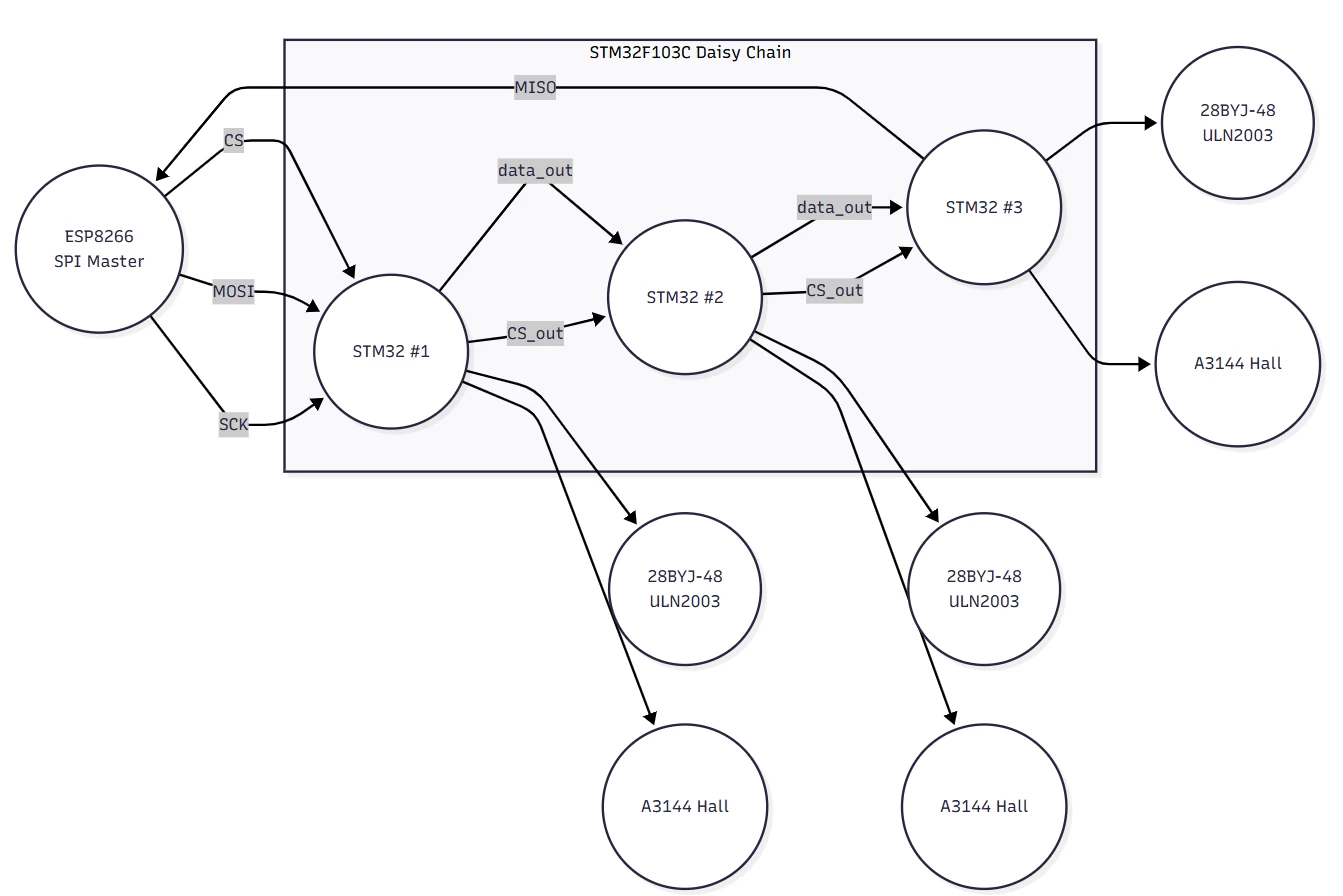

A master–slave SPI network connects one ESP8266 (master) to a chain of STM32F103C controllers (slaves).
Each STM32 drives a 28BYJ-48 stepper motor through a ULN2003 driver.
Communication is full-duplex SPI, where the ESP8266 sends movement or configuration commands and receives acknowledgment or state feedback from each STM32.
Communication Flow
ESP8266 polls each STM32 sequentially via Chip Select (CS) or multiplexed addressing.
Command frame (e.g., [Header][Target Steps][Checksum]) sent via MOSI.
STM processes command, actuates motor, then replies over MISO with [Status][Position][ErrorFlag].
Duplex SPI allows command–response in the same transaction.
Future scalability: plug-and-play detection using pre-assigned hardware IDs or serial enumeration through data lines.

EDIT - This is the diagram:

Your protocol doesn't seem to have any way to address the STM32s ?
You are only applying clock to STM32 #1 - how do the others get clocked ?
As shown, the response from STM32 #1 would have to be clocked through #2 and #3 before it gets back to the ESP.
Similarly, a command for STM32 #3 would have to be clocked through #1 and #2.
Is this what you intend?
@its-nott-me wrote:
allowing modular, plug-and-play addition of slave boards
How will the master know how many slaves are in the chain?

The STX...ETX framing doesn't really make sense for SPI - I presume this is just a hangover from the UART version?

I am fairly new to this.. and I ended up following what claude told me :grinning_face_with_sweat: it's been hard to find a guide.. can you please tell me what should I do.. I can scrap this entire setup and start from scratch.

Still not entirely clear what your project is, or what environment it's going to operate in.
Is it a school project? and industrial product? other?
You talk about motor control. That's often a noisy environment, so rugged comms is essential.
