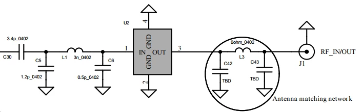

BlueNRG-LP: Recently (Feb 2022), you have released the Evaluation Tool STEVAL-IDB011V2. The BLE-RF-output has been CHANGED compared to STEVAL-IDB011V1 (now NRND)
Is the modified RF-output filtering better in terms of EMI for FCC or CE-certification?
The new filtering in V2 consists of two filtering stages and replaces one integrated filter 2400-2500 MHz.
What is the reason for this change and why did you set STEVAL-IDB011V1 to "not recommended for new design"?
STEVAL-IDB011V1:
0693W00000KbgCXQAZ.png STEVAL-IDB011V2:

Welcome, @WLech.1​, to the community!
the performance is the same.
As indicated in UM2735, section 2.1, STEVAL-IDB011V2 differs from its predecessor STEVAL-IDB011V1 in only two details:
  • U2 (integrated filter in V1) replacement with discrete components (in V2) and
  • CN7 replacement with a 1x4 footprint
Does it answer your question?
Regards
/Peter

Hi Peter,
Yes - thank you for your quick response.
I take both filtering solutions as equal!
