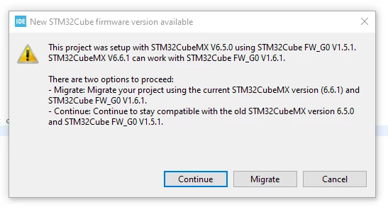

Some new information. I double clicked on the .ioc file to bring up the MX plug-in and I have an icon spinning, and it does not bring up the MX program.
Finally it came up with a window:
0693W00000QLLwmQAH.pngThis is interesting. I did the migration, then went into the MX program to make sure everything looked O,K. It did and then I Generated the Code and recompiled, with a lot of hope.
Still stops in the __NOP(); loop.
