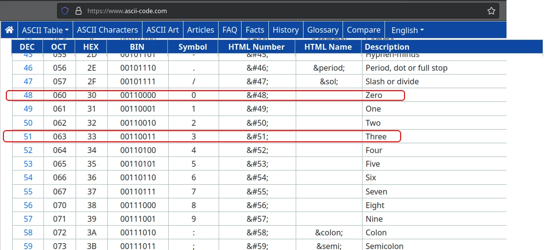

i am sending data on serial is 3 when is display is this 3 but i can conver in bninary then become 00110011 instead 00000011.and when i invert it then i got 01100110 instead of 11111100 ,why so ?

Hello. I guess you are mixing Ascii and binary coding. Ascii symbol '3' equals 51 decimal value and it is 00110011 in binary

How is it possible to convert "3" in decimal to "00110011" in binary?
If it is "3" from the ASCII table then it is necessary to convert ASCII to decimal:
The value of the character "3" from the ASCII table is not 3 in decimal. The value of the character "3" in ASCII is 51 in decimal:
Table here: https://www.ascii-code.com/
Since characters start from "0" to "9", a programmer can convert the character "3" to ASCII by removing the value of the character "0" in ASCII.
This way the decimal value of the ASCII character "3" = equal to the value of "3" - "0" = (51) - (48) = 3 (which is 3 in decimal).
No inversion occurs anywhere in this conversion.

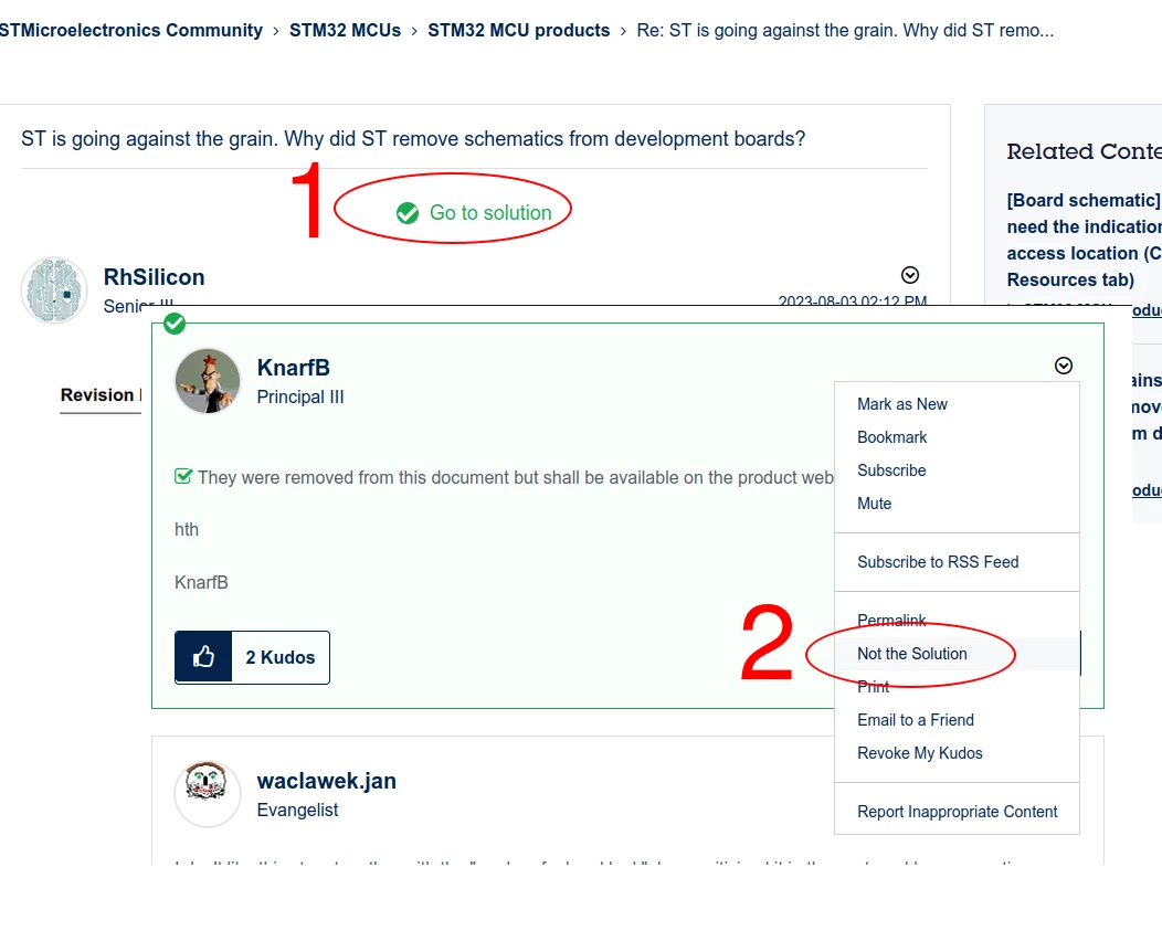

If the problem is still open, it might be a good idea to unmark the post already accepted as a solution (perhaps accidentally, due to a problem with the "Accept solution" button's update time) so that other users can try to help.
